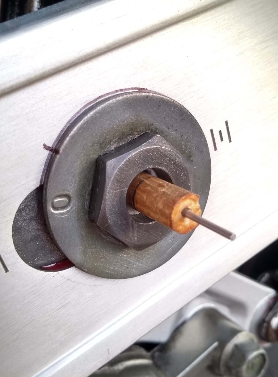

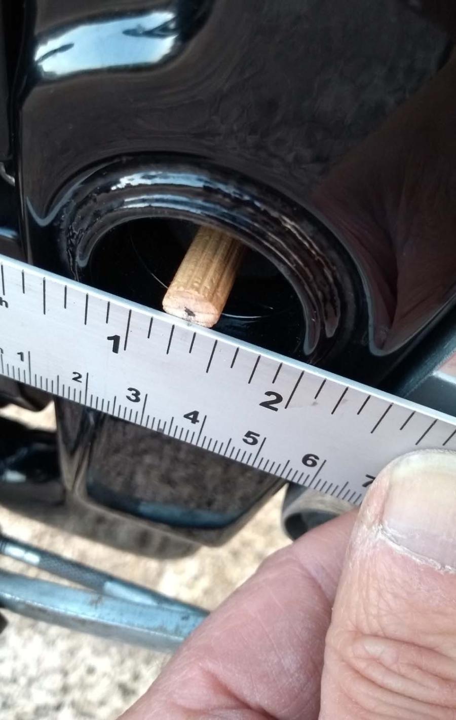

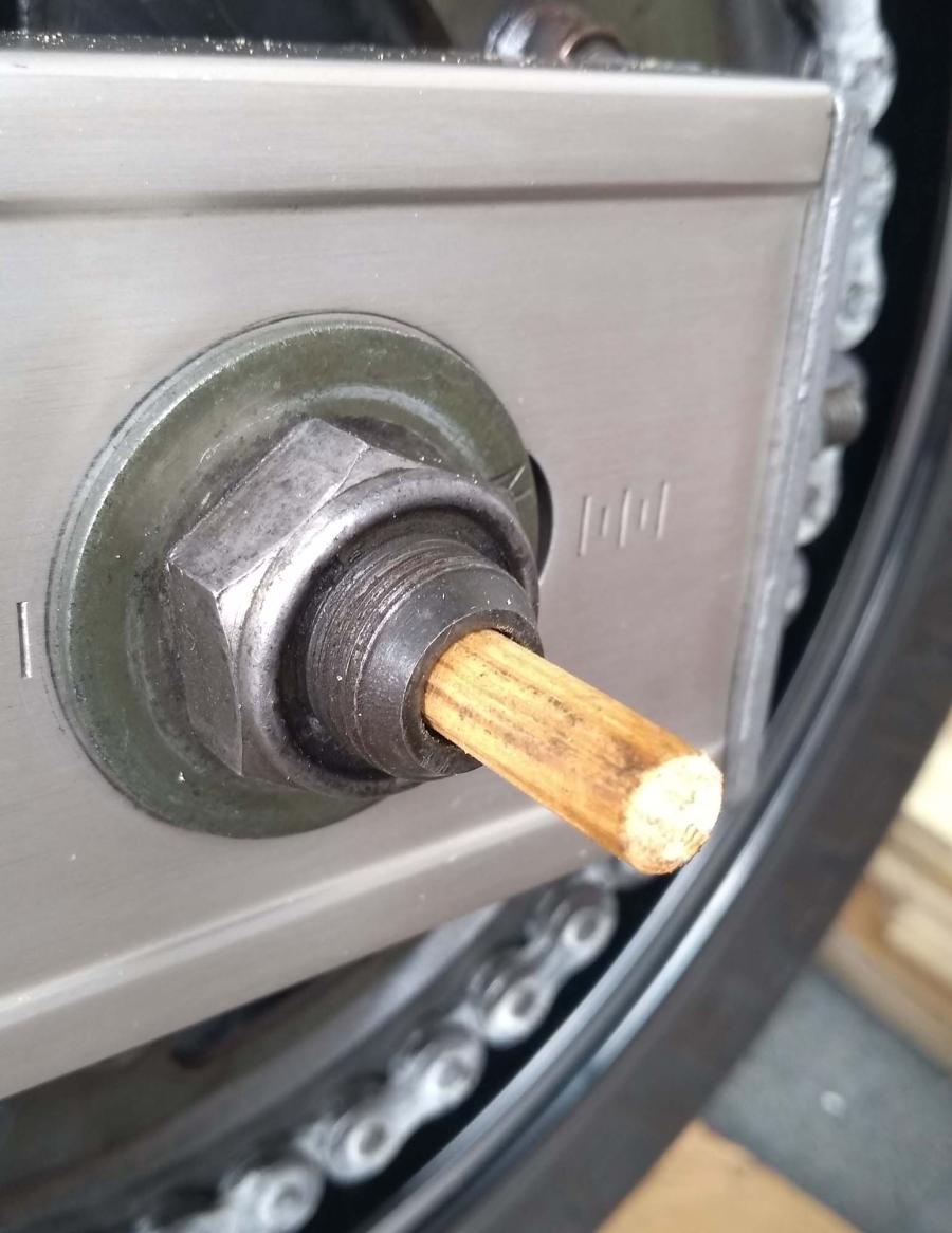

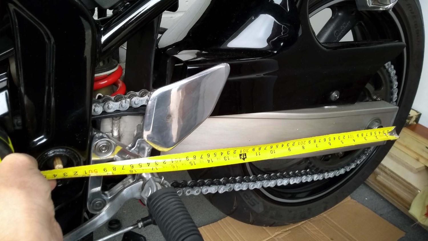

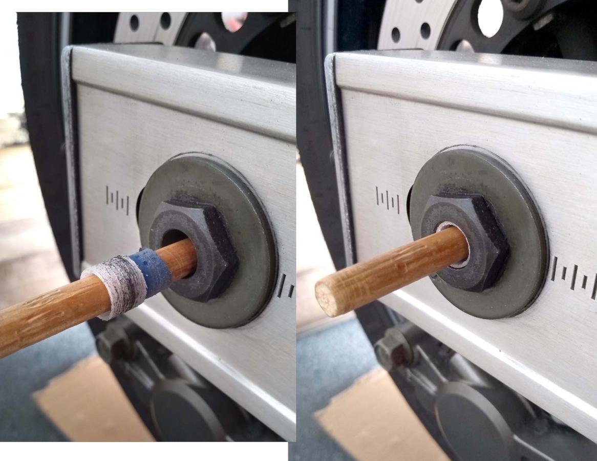

I read that the very best way is to measure from the swing arm but the rear axle has a hole in it which you need to find the centre of. So I came up with an idea to thread a wodden dowel through it. But one side is bigger then the other and it wouldn't work just waggling around so I took the slack up with some spacers so the dowel is held in the centre.

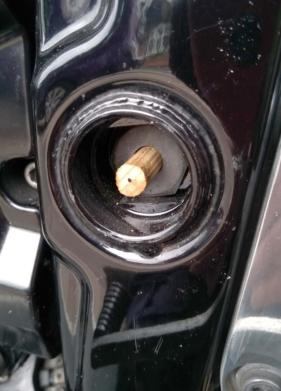

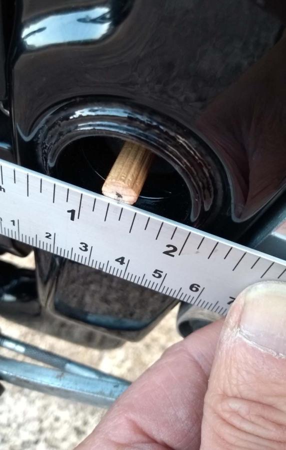

Its the same at the swing arm as each side is a different size hole but I got around that one by sanding down the dowel at one end.Now I can pull a tape measure across which is hanging off the dowel. And I have cut the swing arm dowel flush with the frame and marked the centre with a pen.

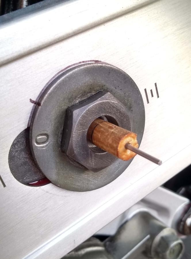

I think I will refine it further by also cutting the spindle one flush and adding a small headless nail to the centre end then use a metal ruler with a pin hole in the wide flat face to slot over my nail and then I can mark the other end on the thin edge of the ruler that lines up with the swing arm dowel pen mark. That way a stiff metal ruler is better than a bendy tape measure.

To avoid any parallax error ( there's something you don't often hear on a motorbike forum )  when I cut the dowel flush with the rear axle and add a nail I deed to make sure that when I hang the metal edge that it is the same distance away from the swing arm face. Because one side of the spindle sticks out more than the other.

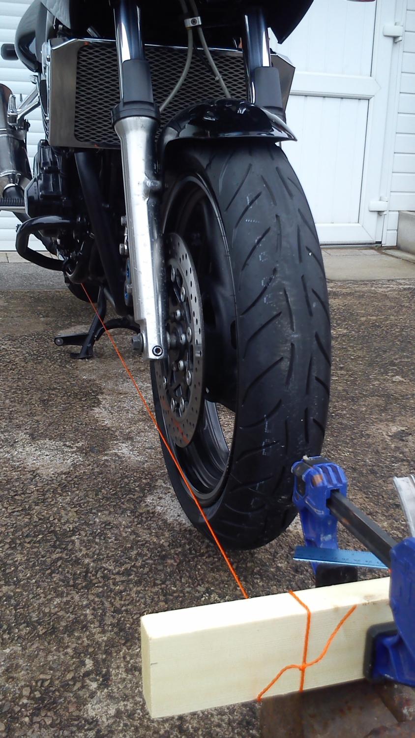

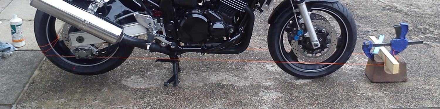

Ive ytried 3 different ways of alignment. Ive used the marks on the swingarm, ive used a metal straight edge on the faces of the sprockets, and ive used the 2 strings between the front and rear tyres method. Using any of the three puts the other two out
(04-05-19, 08:13 PM)agricola link Wrote: Ive ytried 3 different ways of alignment. Ive used the marks on the swingarm, ive used a metal straight edge on the faces of the sprockets, and ive used the 2 strings between the front and rear tyres method. Using any of the three puts the other two out
Start with the markings, spin the wheel backwards, then eyes and ears works for me. It'll be quite obvious if it's misaligned, and also obvious when it is straight when it just purrs with no chain movement or clunky noises.

Before I adjust the wheel I draw around the washer on the swing arm with a very fine pen which adds a 1 mm line I can then pull back the wheel on each side so the washer has just covered the pen. I then remove the pen ad draw a new ring so that I can very quickly see it is has moved - you can see in in my other pictures a few posts ago.

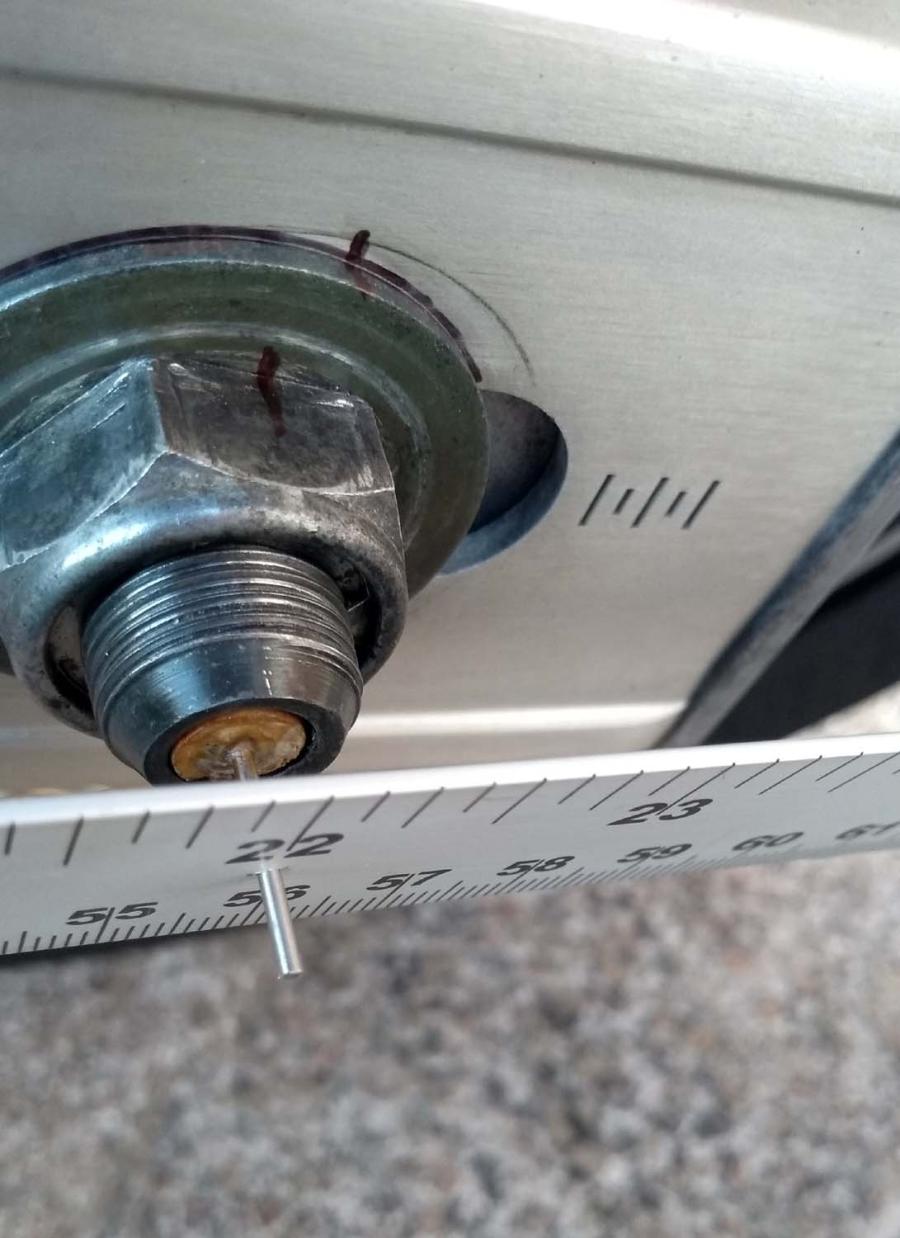

Job now done and I now have the old off and can inspect a little easier. 1 link is stiff and wont bend by hand beyond 20 degrees, about 6 others are movable but stiffer than most and some links are even floppy. The new spindle position is about 1 cm nearer to the swingarm.Its a joy not to have the banging through the peg anymore.Somthing I noticed when measuring the distance from the spindle washer is that there is very slight play in the washer on the sprocket side - the loose washer which gives a false measurement if you use the marks on the swing arm or measure the distance to the adjuster plate. So measuring with my little stick through the spindle and swing arm has to be the most accurate way.

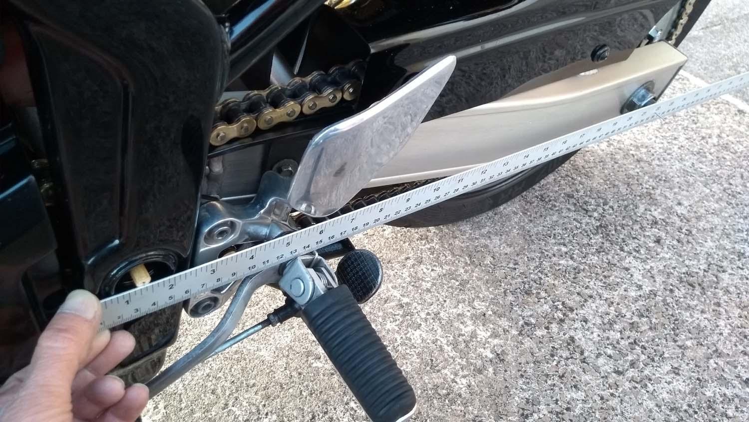

Thought I had added these pictures but apparently not. Here is the refined design with a small pin added to the centre of the dowel. Its actually a 1.5mm drill bit. The 1m aluminium ruler has a matching hole so I can hang the ruler off it. The hole in the ruler is dead centre of its width.
The picture shows the top just because its easier to take the picture. I can use the top of the ruler but on the exhaust side there is not enough room to drop the ruler to use its top edge so I use the bottom edge on both sides of the bike.
The ruler measurement markings are irrelevant all you need is a metal strip and use a pen to make a mark on its edge. A strip of metal is better than my first design of using a tape measure.
In the first picture I have pulled the ruler away but when I measure I push it all the way to the spindle end. Interesting as I drew a mark around washer with the old chain and you can still see it and it shows the difference between the new and old chain stretch (wear  Wink ).
