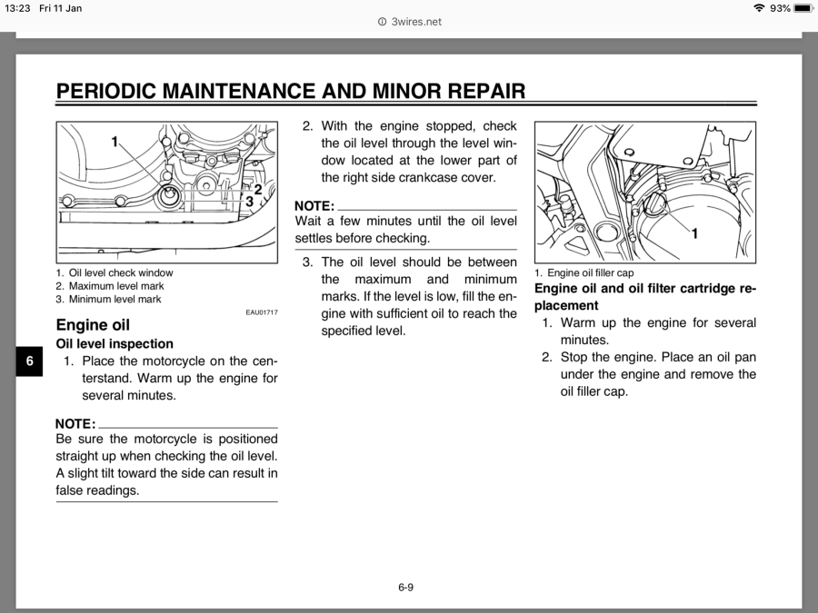

Centre stand, level ground, but you need to start the engine and let it run for about a minute, then switch off and  it’ll settle in about 30 seconds, that’s your level.
Sounds like your oil is too low.
The light is just for oil level, it’s not a pressure reading.
Rather than faffing about running the engine for a specific length of time and then letting it stand for a specific length of time, I prefer to just check it when cold... mine likes it filled to the top of the window, any less than that and it gives the dreaded red light.

Read the manual, and it will tell you run the engine before checking the level, as i said earlier.
You asked for help, and i gave you the answer!
I think the reason is this. If the engine is cold - that means that all the oil that can flow back down has done so. After a short warm up and a couple of mins wait - there is still oil around all the parts that has yet to drip back down into the sump window area. I does seem a bit rubbish to have to read the level via this procedure as it just says a few mins after warm up but the longer you warm it the hotter the oil which will more readily/ quickly drip back down to the window area then the longer you leave it the more oil will drip down so there are too many variables. I would be much better if the procedure was from cold - cutting out all those variables.This would mean that the window would have to be higher as when cold all the oil that will do has dripped down and is near or above the top. I wonder if the read from warm procedure is just because they could not fit a window higher.
The reason is so you don't need to wait an hour after running the engine to check the oil level.
How about this. If it's stone cold the oil level should be at or near the top mark. If it's stopped + a few minutes it should be somewhere between top and bottom marks  Big Grin
(11-01-19, 02:52 PM)Jules-C link Wrote: The reason is so you don't need to wait an hour after running the engine to check the oil level.
That sounds like the most logical reason to me.
