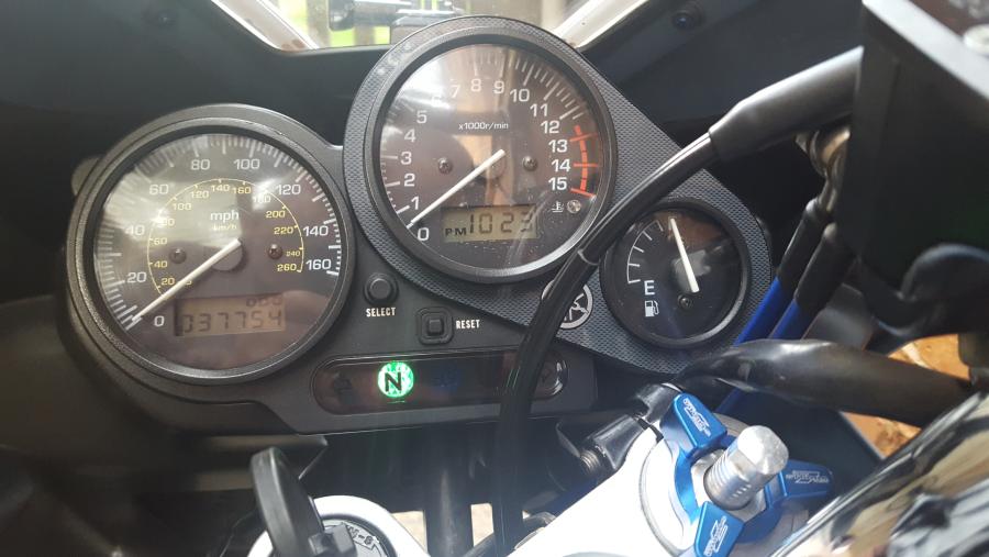

Pic below is my gauge with the tank filled almost to the top of the neck of the fill tube on the tank, and it is reading over Full.
