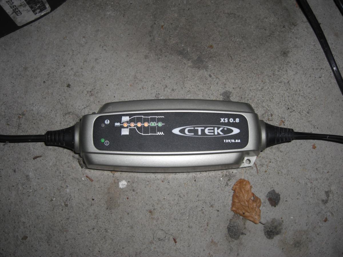

I would advise investing in one of thesehttps://www.ctek.com/products/vehicle/mxs-3-8Aabout 6 years ago I brought the Yam branded one and it brought back to life a flat battery after about 24 hours of doing its special thing . It is also a maintainer and I keep the bike connected to it when not in use which could sometimes be up to 6 weeks. My battery is 20 years old -- it can not last much longer can it ?If I go out it may be for a few hours without any stops, or I may make many stops - if I am trawling all the local Aldi's looking for the correct size base layer special buy. The max time I have left it off charge is about 9 hours.

Fazerider is spot on regards the CTEK charger.
I've had one permanently connected to missus' Foxeye 600 for the last 6 years and it has never let us down.
That includes the bike having an alarm fitted and the bike not moving for several weeks at a time.
Fantastic bit of kit.

Is yours the yam one or Cteck. Mine being the yam branded one I am not sure on the exact model but it has a car mode and bike mode, and a revive program as well as maintain. And looks like the link I posted I have a permanent connection to the battery with a lead that tucks away under the seat and just plug it in when I get back from a ride.

I think the Cteck one uses some sort of special programming that (they say) can revive batteries other chargers can not.

Mine is the CTEK one, which I bought off the internet.
It's the XS 0.8 bike specific one and it did a great job of recovering the battery after it had gone completely flat, which is why I bought it.
