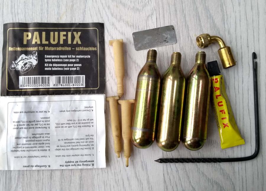

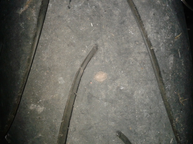

Ive been lucky with punctures but this week I managed to pick up an inch woodscrew in the rear tyre , left it in an rode home 25 ish miles , just about got home with 12 psi left........got up early this morning and thought I would have a go at repairing it with one of the two ŕoad side repair kits I have ,  one a crafty pluggef and the other a FOWLERS version of the same thing , used the fowlers one following the inst
ructions and in about 10 minutes the jobs done , didnt use the air canisters , I'll save them if I ever get stuck in the middld of  nowhere , I recently bought a SLIME compressor to use with the repair kits , connects to the bikes battery and easily pumps the tyre up to recòmended pressure , just a shame both items dont fit under the seat....I'll let the pictures do the talking but happy to answer any questions......well it is FOCU    Wink

I have the same kit as the Fowlers one but without the air canisters. Never had to use it yet, touch wood, but it doesn't fit under my seat anyway!
I've been thinking of getting the Dynaplug kit, nice and compact.
Glad it worked, be good to know if the bike feels any different with the plug in the tyre.

Good to see you got it fixed, but I'd recommend going to see Russ at Russ' Tyres in Burrfields, Portsmouth to get him to check the inside of the tyre, because you never know what damage may have been done to the inside of the carcass.
BTW a group of us from the Solent IAM group went up there a few months back and spent an entertaining few hours making holes in tyres and then trying out various puncture repair kits to see which worked best and the Crafty Plugger did seem the most effective.
Hi graham , yes indeed , all of these roadside repairs are only designed to get you home with plenty of warnings on the packaging
its holding pressure well so going to take the old girl out for a test ride , will report back shortly.....

Had a little bimble up to ace cafe for the vintage Japanese bike meet , tyres held pressure over night and no difference to the waythe bike rides / handles , about 40 miles or so , repair is still standing slightly proud but its working    :thumbup

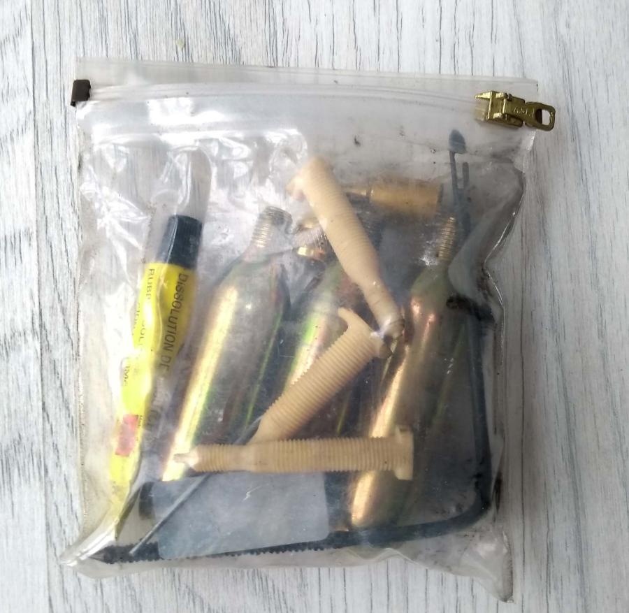

Well thats all good , but how good are the air canisters  ?  My kit is probably 3 /4 years old , do they have a shelf life ?  would I need all three to get enough pressure in the tyre to get home ?    Anyone used them before ?

I was speaking to a guy at my local bike meet today who said he used the plug type repair same as these, the repair bit was ever so slightly proud of the tyre for a few days after the fix. He set off from the lights one time a bit spirited like and it ripped the repair out of the tyre. I guess they are only supposed to be a temporary fix like, but I thought I'd mention it as something to bear in mind.

Me too. I have a kit under my seat with canisters - time fly s l bet if I got hold of the receipt from Hein Gerick it would be 8 years old
I can't see why a canister would have a shelf life?.. But i personally have never liked them. If they are small canisters you can lose a lot of air, if you have a leak attaching them to the valve.. and be careful you don't freeze it to your hand and burn the skin off (as I watched a mate do a few years ago)

(02-09-18, 06:35 PM)red98 link Wrote: Well thats all good , but how good are the air canisters  ?  My kit is probably 3 /4 years old , do they have a shelf life ?  would I need all three to get enough pressure in the tyre to get home ?
No, they don't have a shelf life.
Three will give you enough pressure to get you to a garage with an air pump, but I wouldn't go over 50mph and I wouldn't rely on them for long distances.
Here is mine that I keep under my seat but as I said it may even be 10 years old brought from hein gerrik- hopefully the gas will still be ok. You even get a cute little piece of metal to use as a knife to cut the excess off. That is really good advice about the canisters freezing.
