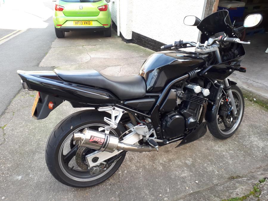

If you dont intend to carry pillion like me then I think removing the grab rail and lifting the numberplate right under the rear light and cut the rear guard flush makes the back end look better and is very cheap to do but also to be leagal you need to add a reflector at the bottom - my picture is before I added it and a hugger looks good with it too.

Here is another angle, there is scope to further shape the mudguard until you get too close to the turn signal stalks. I covered the gap rail holes with black gloss sticky vinyl in a lozenge shape covering both holes with one piece but two layers to make it thicker it is nice and flat and unless you are standing next to the bike you can not see them. I was easy for me because its black but if you have a colour bike then you may struggle for a match I suggest you could go to a local sign makers who will have a big selection of colour vinyl on rolls.
I used the same mounting holes in the guard so needed a new plate so I could drill the holes in the new position on the plate.
