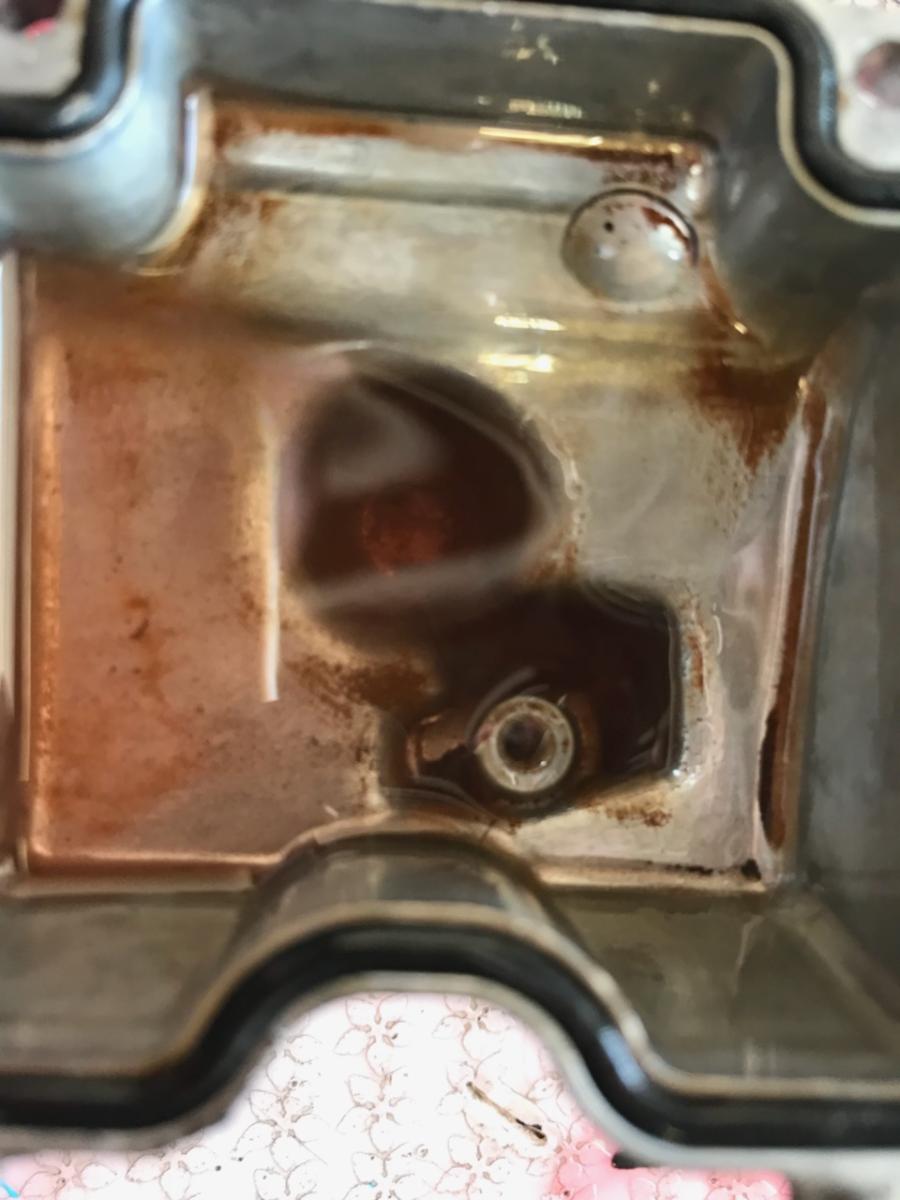

for all you guys getting your carbs stripped, share pictures of what they find in there!!
I've never seen a blocked carb and would be interested to know what it looks like and the sort of thing you find.
-suck-squeeze-bang-blow-
Here is one of my float bowls.  Sad
okay so cleaned the carbs i will get them back on tommorow so hopefully i might have all cylinders again....... the float bowls where  full of rust...... so we will see if it gets any better......
Wow, surprised to hear that. Check your fuel filter and air filter! That rust must have got past one of them.

okay so any ive put the carb back on but cant seem to ge the throttle cable back on ?? any suggestions...... i have changed fuel filter with new one now air filter doesnt look that bad..... but i will order a new set for it a couple of the jets did have crap in them.... but in the end i think i need to put new seals on everything they are shot basicly.....
