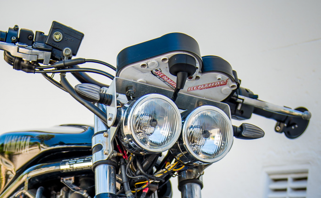

Looks good! Could you post a picture of how the clocks are mounted to the headlight brackets? I'd like to do something similar.

(21-10-17, 10:55 PM)Drezza link Wrote: Looks good! Could you post a picture of how the clocks are mounted to the headlight brackets? I'd like to do something similar.
It's not very clean, I actually want to get an entirely new speedo but here is a close-up:
