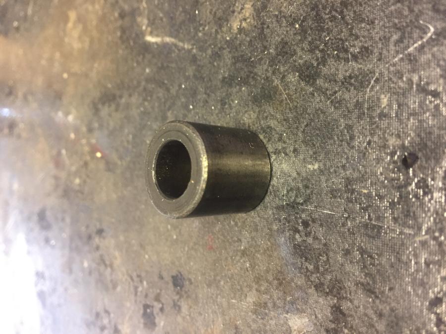

After putting it back I found this spacer thingy, I know I haven't removed anything that it's come from, maybe it just came loose and fell when I was doing the exhaust, any ideas where it's from? It's about 16mm long
(26-08-17, 04:52 PM)Panthor link Wrote: After putting it back I found this spacer thingy, I know I haven't removed anything that it's come from, maybe it just came loose and fell when I was doing the exhaust, any ideas where it's from? It's about 16mm long
Looks to me like the bush from the exup assembly end plate - http://www.cartestsoftware.com/fz1/image...ance04.jpg
That's what I suspected but I found this whole the exup was still in pieces and all the exup parts were there
Are you sure all the EXUP parts are in place?  That is definitely an EXUP valve bush and there are two of them, one in the end plate and the other goes on the end of the valve spindle into a housing on the far side of the collector box.
Incorrectly fitted EXUP/badly adjusted EXUP cables will give you the rattle noise you described earlier.
I'm pretty sure, but I'll take it off again to be certain. Although I remember trying to see if it fitted on before I put it all back together
This gets weirder, the bushing is in place in the exup valve but this one is exactly the same.

That is one of the bushs that the exup rotates on. Mostly likely the one in the Collector box
(27-08-17, 11:30 PM)unfazed link Wrote: That is one of the bushs that the exup rotates on. Mostly likely the one in the Collector box
After reading the exup service guide again (more carefully) I see that the there is a bush that can come out fromt the collector box as you say. I think I was thrown as the first time I had it apart it stayed in place. Well guess I'll be opening it back up again in the morning.
