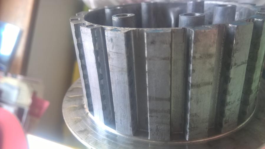

Another thing you should check (I forgot to mention), where the teeth of the metal plates locate on the inner clutch boss, they can wear little grooves in it. This can cause the clutch to stick and might be an issue now you've fitted new plates.
I'll take a photo and add it on....
Brett
-suck-squeeze-bang-blow-
This wear might explain why it behaves differently when you reorientate the metal plates.
This one in the photo is hardly worn. I've seen a lot worse!
