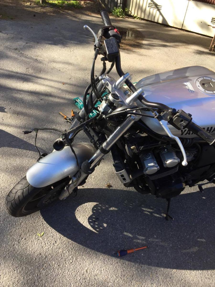

All lights working now, just need to replace the big ugly speedometer and change the headlight to a new one.
But that´s next winter project so this will be my ride this summer.
Looking for a new exhaust, so that will be fitted during summer.
Also need to clean up my garage :-)

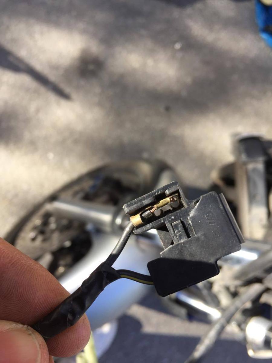

If i buy a new H4 female connector. I still doesn't have a male to connect it too? What am i missing. Do you just plug the cables from the lamp into the new h4 connector with Cable shoes?
On the original headlight the bulbs are the "male connectors".

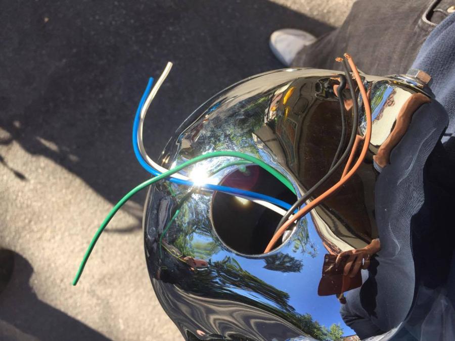

So ill take my chords. Hi beam, low beam, and two chords of Earth and twist em, And put them into a connector. Then ill buy a new H4 light with a male connector. I may open the headlight first, but im worried there wasn't a H4 included. Why would it have all these loose chords. Thanks for your pedagogical pictures Smile
WTF?
You haven't even opend up the headlight?
You have 5 wires in that photo.
sidelight +ve and -ve - this will go to a bulb holder
Headlight dipped, main and earth. - This will go to the connector that goes onto the back of the bulb which may not be an H4. Doesn't matter though. Just cut off your existing H4 plus and connect the wires directly to the loose wires you have coming out of the back of your pod in the photo.
No feccing about needed.
A
Thank you for taking time and responding to me. I took my bike to my father in law. i just stripped it in minutes and left it in the garage. I will check as soon as i can. And let you know how it went!
Hi! I did the headlight conversion first, easy peasy. Reused an old connector i had, now everything work great :-)
