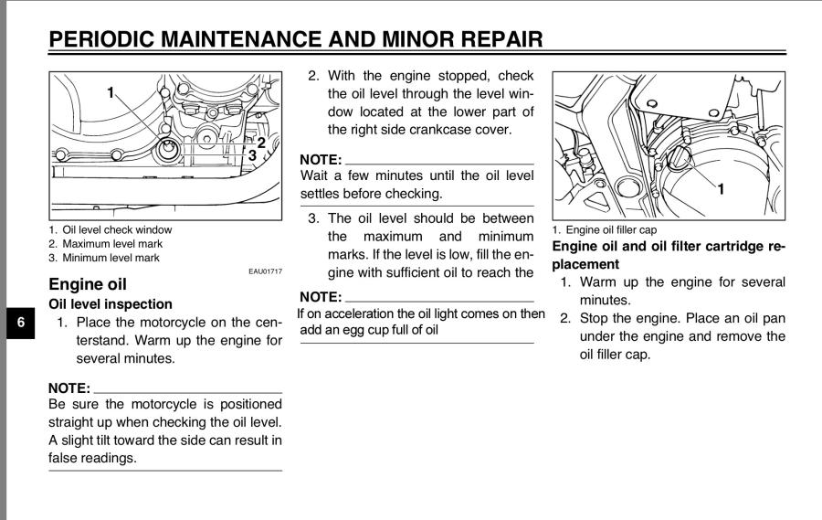

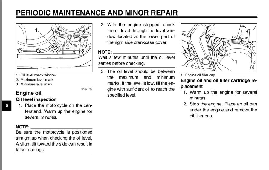

(18-04-17, 01:24 PM)darrsi link Wrote: You and your egg cup  :lol
You need to read the workshop manual that you posted again
(18-04-17, 02:44 PM)fazersharp link Wrote: [quote author=darrsi link=topic=22395.msg258680#msg258680 date=1492518281]
:rollin :rollin :rollin
