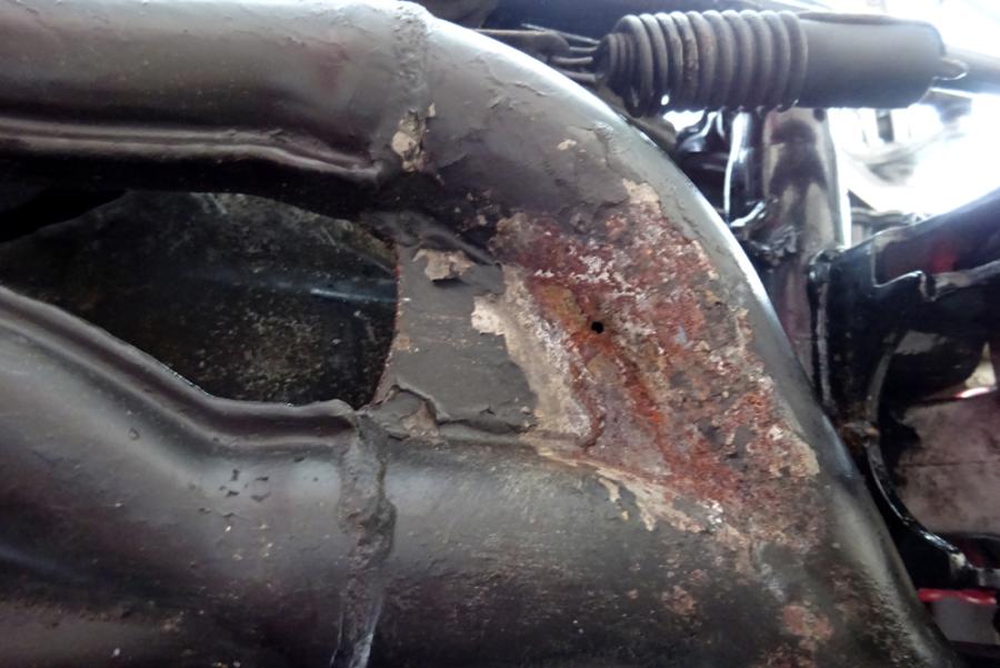

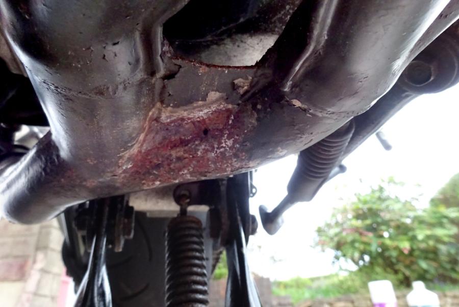

Here is my holes last year after I had cleaned it all off with a wire wheel on a drill being on a curve how easy it it to weld a piece over it and how much would that cost over a new exhaust
[Image: index.php?action=dlattach;topic=19727.0;...4122;image]
Job when done last year
[Image: index.php?action=dlattach;topic=19727.0;...4141;image]
[Image: index.php?action=dlattach;topic=19727.0;...4139;image]

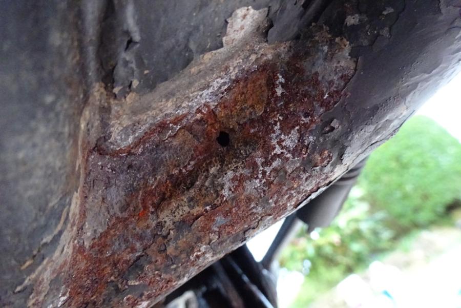

Here are some photos from tonight, one hole seems to still be taken care of by the gun gum but I doubt when I get going with the wire brush it stay there and will drop off.
I have got myself some chem metal to fill it.
Also photo showing some rust spots coming through the paint so I don't think the Rustolum was all that good. Open to offers on a better one
