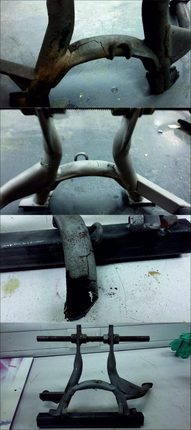

Something to be careful of is the bracing bar between the legs of the stand can rust/fracture and if it is getting weak it can flex too much and make it difficult to get it on the stand.
However, I agree with ruby, best to take it off, lube it up with a paste kind of grease rather than watery oil that will wash out. Would also be a good opportunity to check it over for any weak points.

Yes watch out for that, it shouldn't have a feeling of seizing half way, sounds very much like the rotten crossbar issue but take it off and give it a refurb  like I did here
http://foc-u.co.uk/index.php/topic,20049...#msg231855
Yeah, I bought a second hand good condition one and had it powder coated to protect it. My old one was starting to crack where the centre stand joined to one of the legs and it was definitely harder to get it on to the stand.

I would hazard a guess it's bent out of shape.
You can't really tell until you remove it though, then all will be revealed.
There's not much to them to be honest, you can repair them fairly easy, You can weld over small cracks and add strengthening plates across very badly corroded areas.  Smile
I repaired mine last year, by replacing the corroded piece between the legs,
