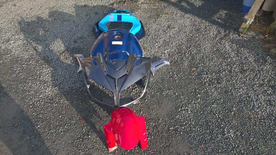

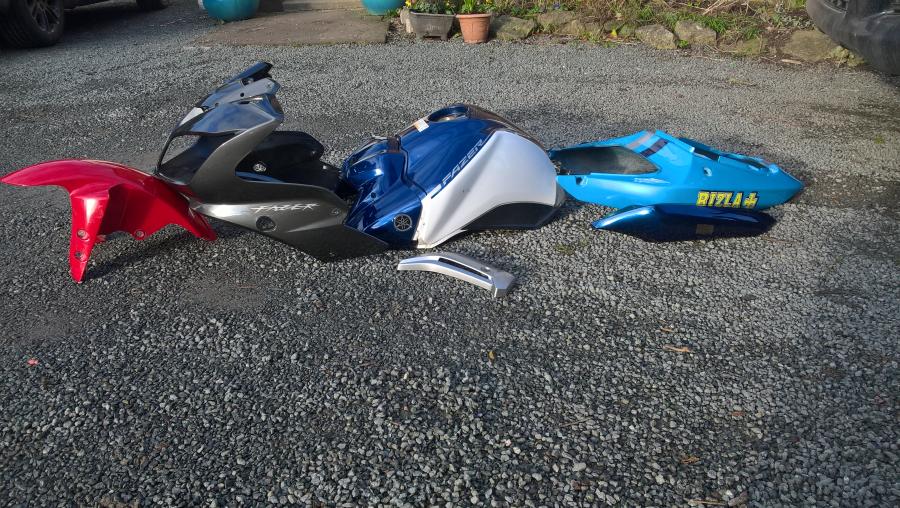

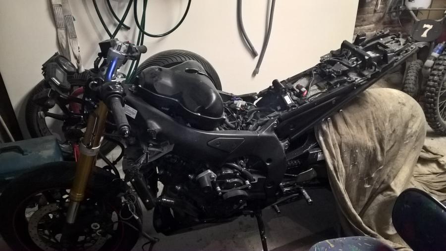

So first was the collection of plastics and tank
Odd line up

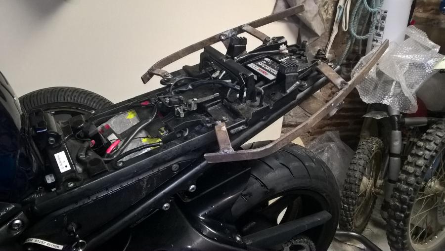

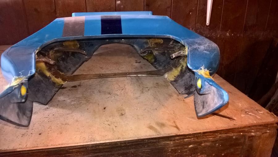

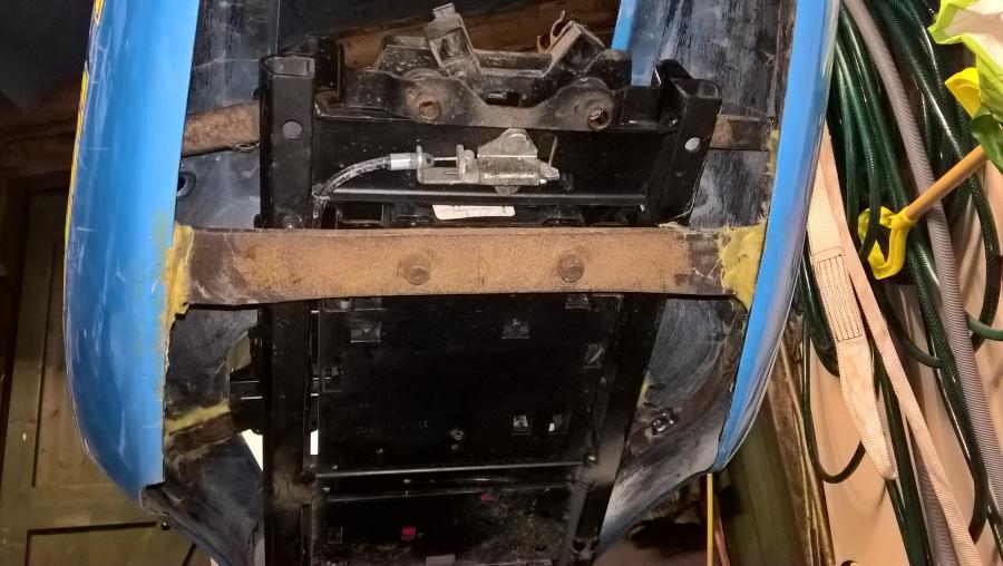

A steel frame for the Gixxer tail end

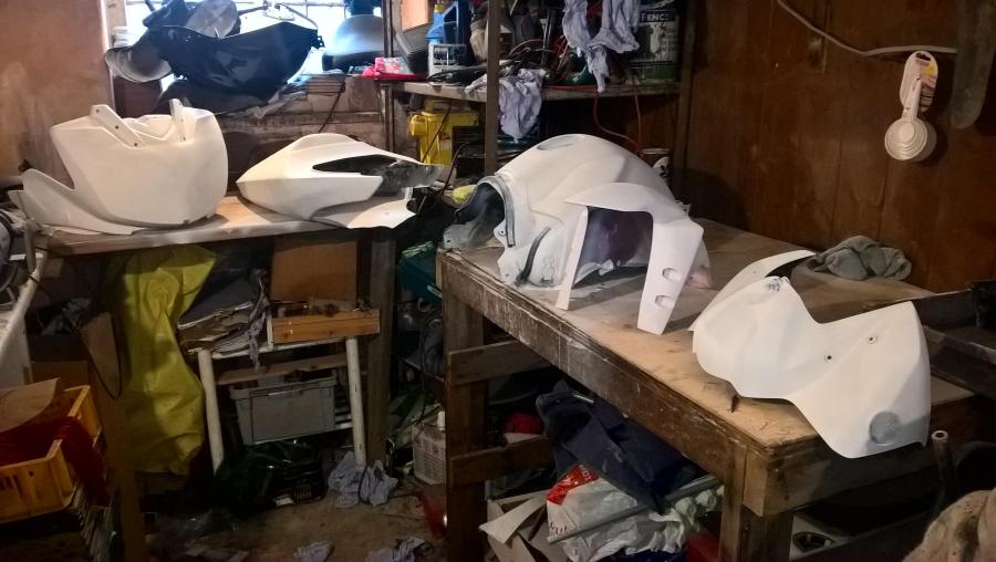

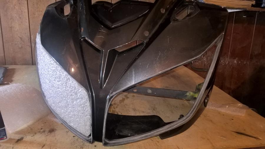

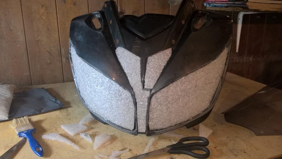

Then to flatten the front fairing, blank out the light holes
https://www.google.co.uk/url?sa=t&rct=j&...4739,d.d24
Filled in with form foam

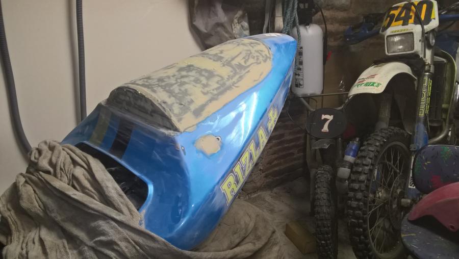

I got lucky , the Gixxer tail slipped over perfect,

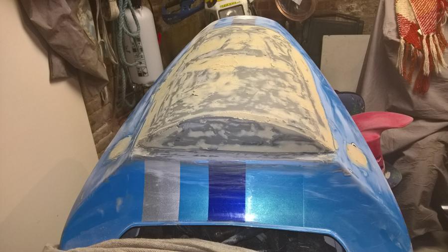

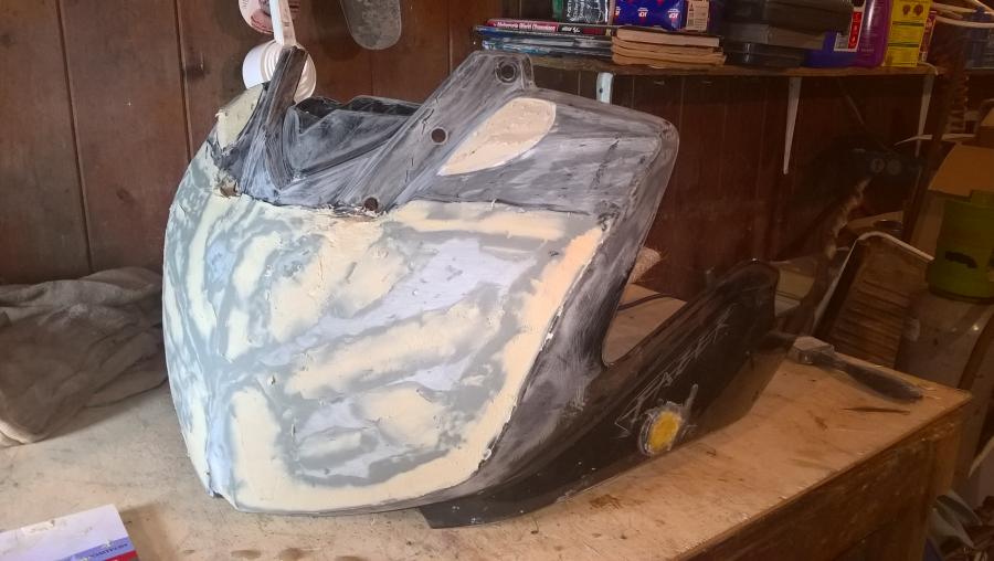

Fibre glass , filler , what else is there to do in January
Frame fitted and stuck
Seat filled in
Looks ok

Lots of filler,sanding , well a bit ,does not have to be perfect

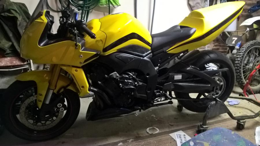

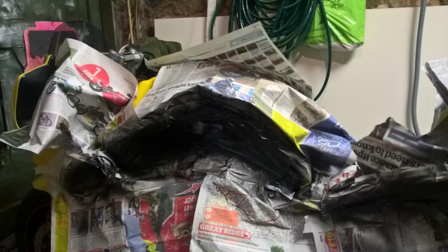

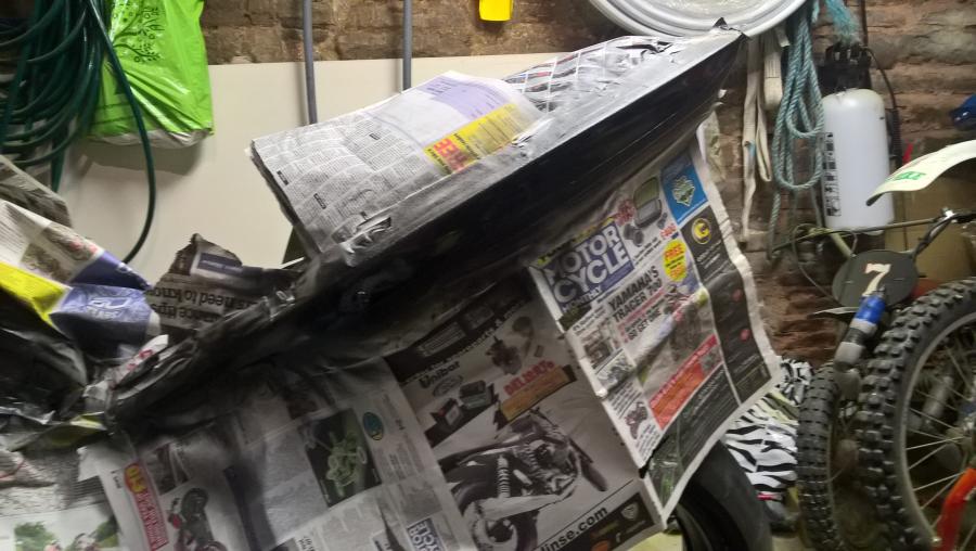

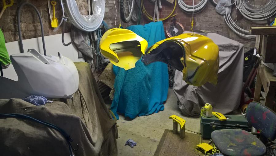

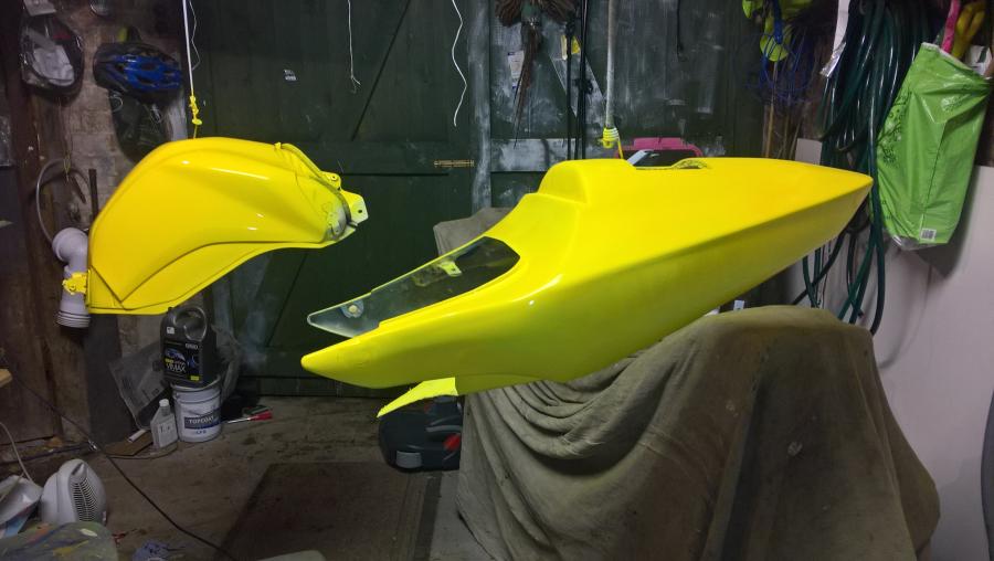

Rattle cans !!!!! yes , five cans of yellow,,, yum yum, I like the smell in my shed ,lol
I decided aerosols would be fine and easy for me to repair if needed
Sill picking out Yellow bogies today  :eek  :lol

[Image: 208008.png]

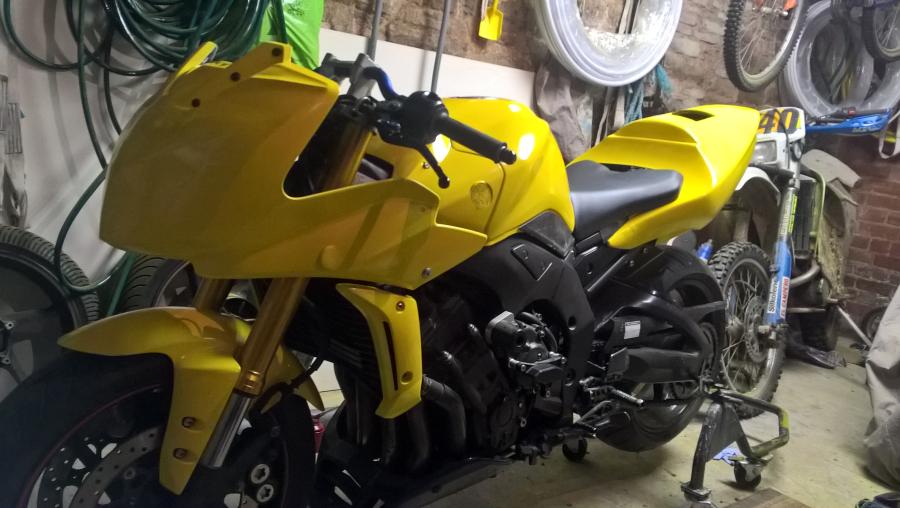

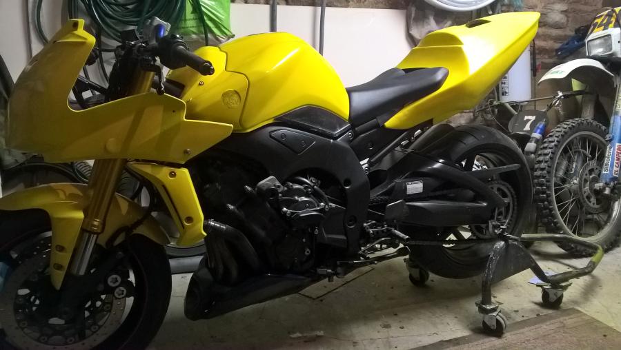

Bright yellow
Then black stipe
A bit rough and ready but from the other side of the road it will look ,,umm ok  :lol
That's it up until today, stickers and pinstripe arriving daily,
