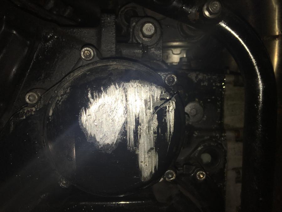

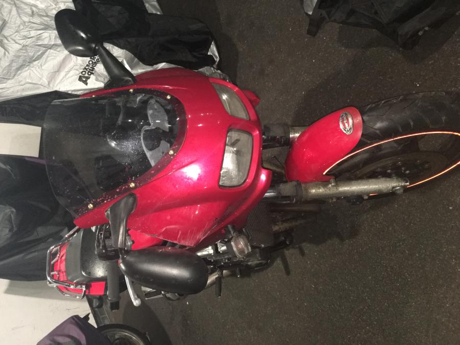

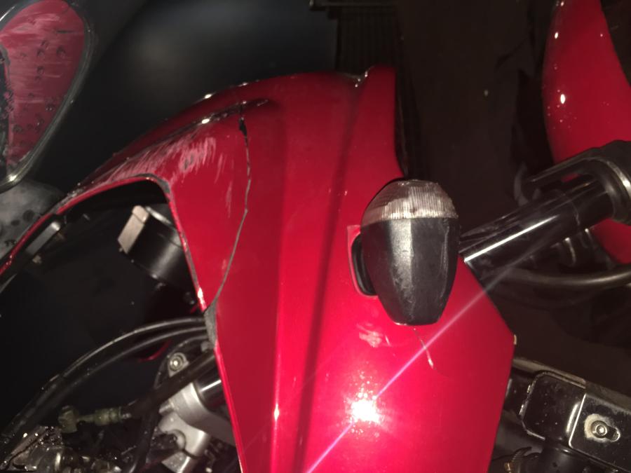

Hi guys
last night I was out ridding and approaching a green light at about 30mph when out of nowhere 4 people ran out into the road hoping to cross, I had to swerve to avoid them but sadly lost control and came off. I've managed to escape with just a fractured wrist, however the bike is a bit beat up, both mirrors and right side indicator are loose, front fairing is cracked and scratched, exhaust completely fell off and bent, and lastly the right hand side engine shell cracked and allowed all the oil out.
As you can imagine I'm gutted and heartbroken, I love this bike with all I have, and all I want to know is if it is fixable, I know mirrors, indicators, fairings and exhaust all are but I'm so worried about any potential other damage caused by cracking the engine shell, at the moment I just can see there's no oil left in the engine.
Photos of broken bits are attached  Sad

as long as it wasnt  revving its balls off with the oil leaking out i dont see their being any damage get a new casing on it new oil and she will be right

I'm no expert but I guess that as long as the engine cut out before it lost the oil then the internals should be ok. I guess other things to consider are engine mounts, twisted frame etc
Hope it's fixable, best to get it checked out by a professional before diving into the repairs.

as said as long as it wasn't revving it's nuts off dry of oil , new casing and fresh oil and filter, but as others have said I'm not an expert just had a similar off years ago mines still running now.
As it was nob head pedestrians you've got no 3rd party to claim off are you fully comp ?? If yes then it's a write off , buy it back and fix it yourself if assessor report is ok , if no and you're on a budget I've got a casing you can have for the postage if it helps you out.

Just wanted to confirm I'm not sure what revs the bike was doing when it landed on the floor, however i can confirm that I hit the ground, stops sliding across the road and the literally crawled as fast as I could to hit the kill switch, the bike was maybe on for a max of 5 seconds after we came to a stop. Hope someone can confirm whether i did the right thing or not.

Not good to hear of fallen foccers  Sad ....but as above your ok  Smile .....you did the right thing hitting the kill switch, cant see you having problems there.....great offer from GRAHAM53  :thumbup  make a list of the parts you need and post them in the wanted section . Iam not far from you and a rummage in my shed might find something you need........

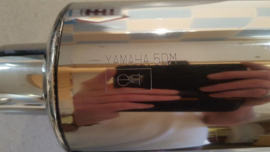

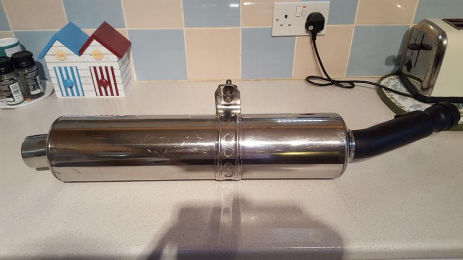

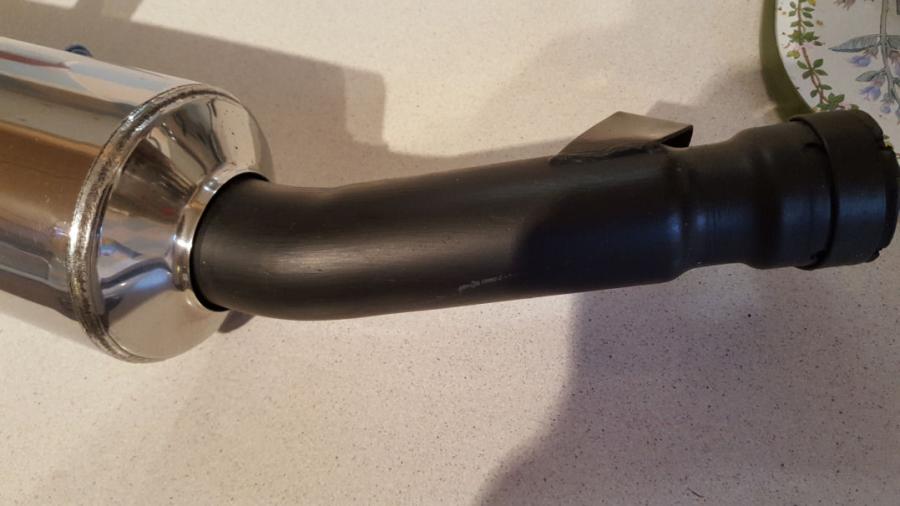

Where abouts are you, as I replaced my silencer on my 2003 FZS 600 with a smaller sports can a couple of years ago, so I have the genuine Yamaha one in my shed, it is in really nice condition, you are more than welcome to that if it's of any help, and if you local (ish) to me, I could drop it off.
I would imagine its the same silencer on all the FZS 600's unless someone know different, the one I have is from a FZS 600 2002-2003 Foxeye .
Just retrieved it feom my she dusted it off and pics below. Yours for the taking if its any help. Sorry to hear about your off last night, what a  :'( bummer.
Your engine will be fine, unless you rode it home.
Just replace the cover and top up the oil. Get yourself a new gasket, or a tube of that autogasket stuff (like toothpaste), or if your desperately stuck working on your bike late on a Sunday night. Photocopy the cover onto the side of a cornflakes packet and cut yourself out a new gasket with a knife or scalpel.

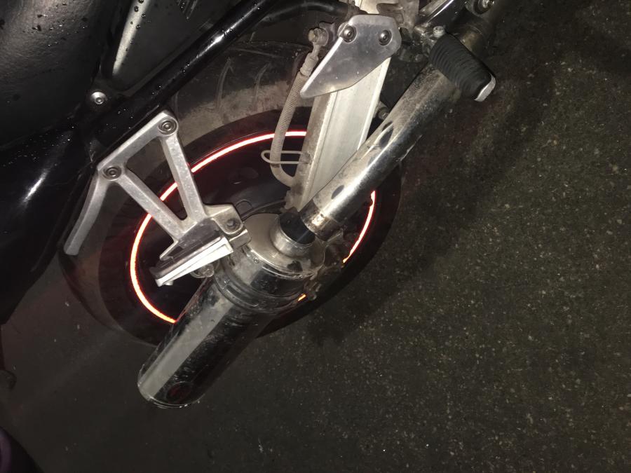

It's not clear how your exhaust has failed, does one piece slot into the other and the weld has failed? You might be able to slot it slot back in and clamp it. You might need to hacksaw or dremel a slot in it and clamps are readily from places like Halfords.

Looking at the picture he has an aftermarket end can also with an aftermarket stainless link pipe. Looks like the can is oval.
The after market can may just be a push fit on the link pipe and the can has just got dragged backwards off the pipe as the bike slide on the road.  The strap clamp looks very close to the front of the can, I'd try loosening the strap and just push the can back on the pipe and if it leaks then try a clamp round it

Agreed , a lot of aftermarket cans slot on to the link pipe there and the tide mark on the link pipe looks like that the case or even that it had a clamp there that's slid off when the zorst parted company with the link pipe.

[/quote]You are absolutely right you can see the tide mark on the link pipe and also a corresponding tide mark where the can has slipped through the clamp. should just push back on
