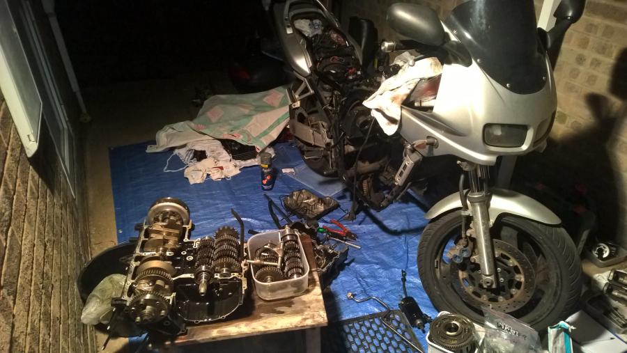

I knew about the issue, but naively assumed that any Fazer still on the road would have had it fixed by now, i.e. the upgraded nut and if necessary a new shaft.
Anyway I'm in the process of restoring the bike, and had planned to have the engine out next winter anyway. So I'll drop the motor out and repair it properly with a new shaft.
