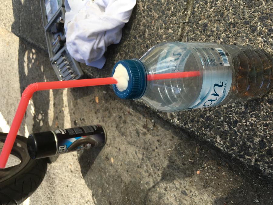

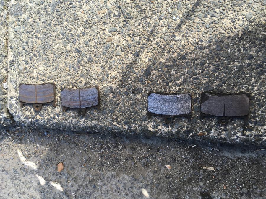

MOT happened a couple of days ago. The bike passed but I had a warning about the front brake pads being very low. I replaced them today mostly without a hitch (pics of old ones attached). Because of the extra friction material on the new pads (SBS sintered), it looked like there was now too much brake fluid in the system as the brake lever barely moved before stiffening up. So, I syphoned off some fluid from the master cylinder (homemade syphon pic attached) but the lever is still stiffening too soon. The front wheel turns easily but not freely so the pads must be touching at rest. The master cylinder fluid level is just above the low mark now and the lever indicator is on '1'.

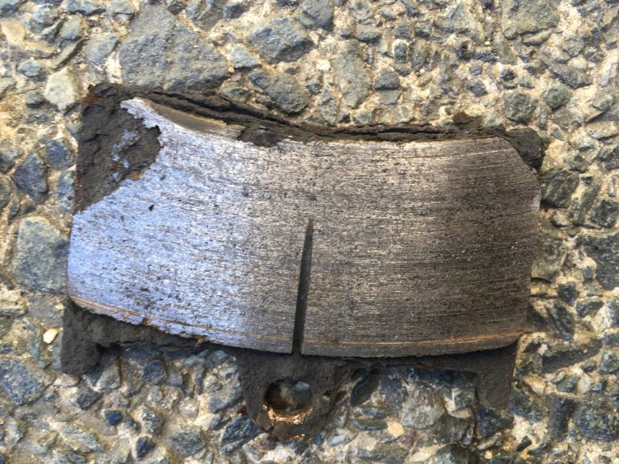

Finally, as you can see in the picture, one of the old pads has worn unevenly. I'm presuming this is because the callipers need cleaning. How easy is this? Can anyone point me to an idiot's guide?

Like your home made syphon  :thumbup

Did you clean and inspect the pistons?
If you're fitting new pads, as they are thicker the pistons will now be pushed into the caliper a bit more than before, so your seals will be running on part of the piston that was previously exposed to the elements.
If it's scratch, corroded or dirty it will not move as smoothly on the seals. Typically, driving the piston back out a bit and going at them with an old tooth brush and brake cleaner will sort it out followed by a smear of red rubber grease.
....Else just run it as it is and the exercise and thermal cycling may free it up. :-)
Just be aware the danger is, if it binds and drags too much, two things: Heat will build in the disc and it'll probably warp it, as well as wear. OR heat builds up in the caliper, the brake fluid turns to steam and pushing the pad even more against the disc and when you do pull the lever it'll come all the way back to the bars with no effect.
