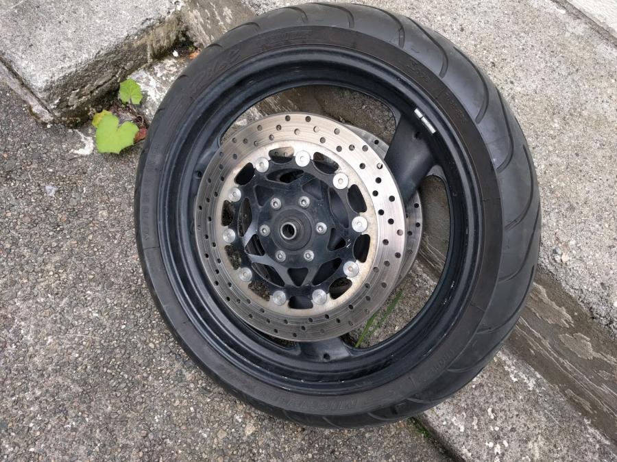

Wondering though, when I see the schematics the spacer (#8) on the right hand side should be the other way around?
With the flange towards the outside?
When I took the wheel off I noticed the spacer was "inside" the seal. So I just put it back together the way it came out. Any thoughts?

Looking at this picture it's obvious that the spacer should not be in there by default. Seems like the other owner got it wrong. I've ordered a new  axle wheel bolt and will be refitting it as soon as I get it. I'll just take the time and see if I can fix the seal too without damaging it.

Yes, I know the wheel spacer goes on the right hand side of the bike. But it is possible to have the flange of the spacer within the seal or outside. It's probably fine either way.

The wheel spacer "sits" part way inside the seal & abuts the wheel bearing so when you instal the axle & everything correctly positioned & tightened up there should be no sideways play in the wheel ,if you grip wheel on opposite sidesand try to rock it sideways. Wheel should rotate freely when you spin it by hand without any nasty noises or roughness
