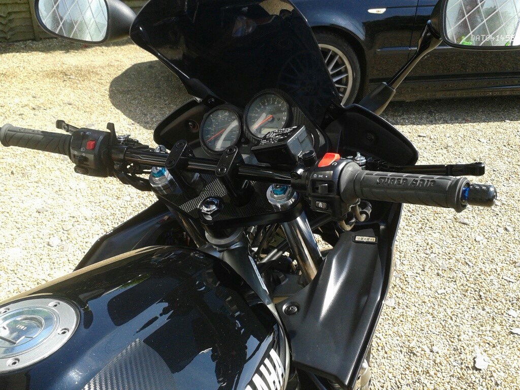

Hi all, fairly new to this site, but like the banter and sound advice, after reading an old post on this subject I had a tweek with the bike, dropped the forks 10mm through top yoke and changed handle bars to straight drag type, if you like a sportier riding position and a bit sharper cornering then give it a try, its easy to do and free..
Forgot to add that I had to cut a gap in the plastic dash panel to allow free movement of throttle cables, need to check that throttle operates properly on full lock...

Wow, diamond leaded mirrors!
Did you do those yourself?  :lol

Nice one!! I never even noticed that my mirrors were so cool, took me ages to get the lead to stick..lol....cheers for the welcome..adey
