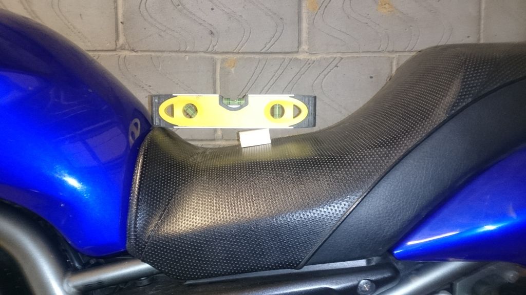

It's got less pitch as shown by this before-and-after pair:
Before:
[Image: DSC_0133_zpsvibknuo4.jpg]
After:
[Image: DSC_0158_zpssgmvalec.jpg]
And the rider-to-pillion seat rise is much more of a step-shape rather than a slope so you can get your arse back in there without it constantly sliding forward down the slope.

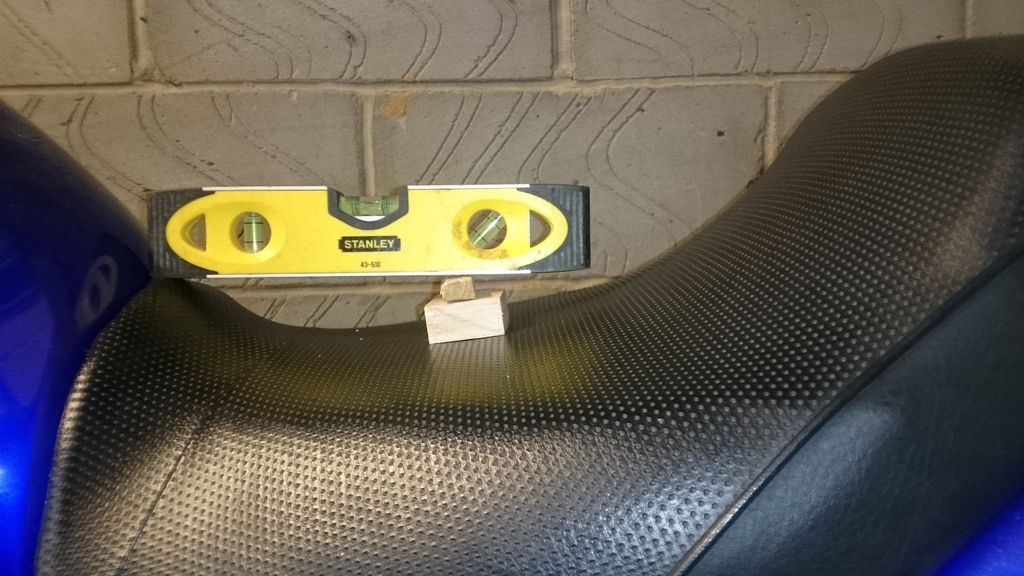

And these two show how the seat has been flattened out side-to-side (better cradle):
Before - convex arse cracker:
[Image: DSC_0134_zpspqqrlfrm.jpg]
After - flatter - much better:
[Image: DSC_0160_zps4iskpx2p.jpg]
