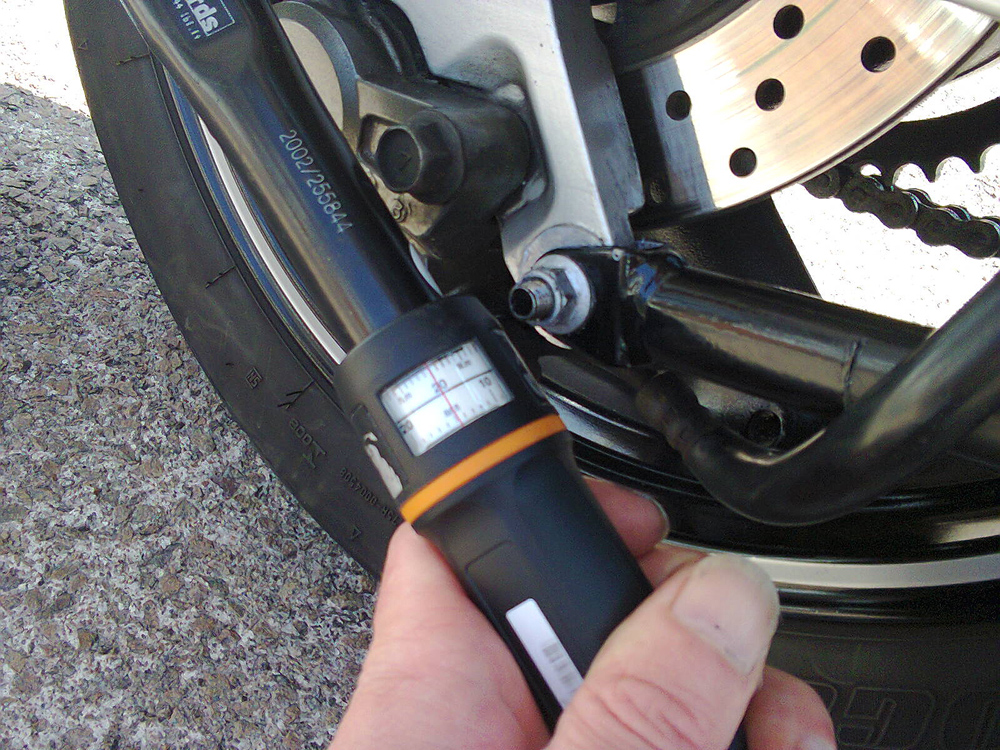

(10-05-16, 05:07 PM)His Dudeness link Wrote: think that nut is 23NM. page 7-62 of the yamaha workshop manual
Yep you are right - now all done resprayed re greased although only did to 20nm but I dont think they are going to come undone as they are all metal locknuts but I will keep an eye on them.
