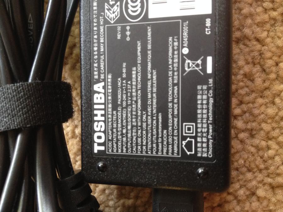

It says
output 19v 2.37A
and has a 2 pin figure of eight input on the mains side but the plug to unit figure of eight part is ok

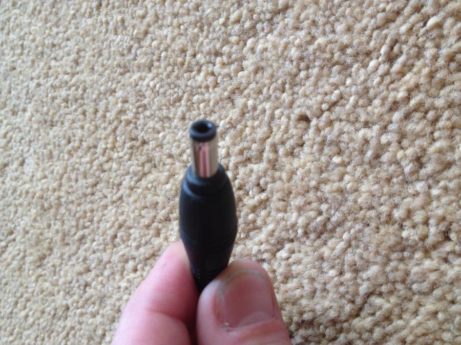

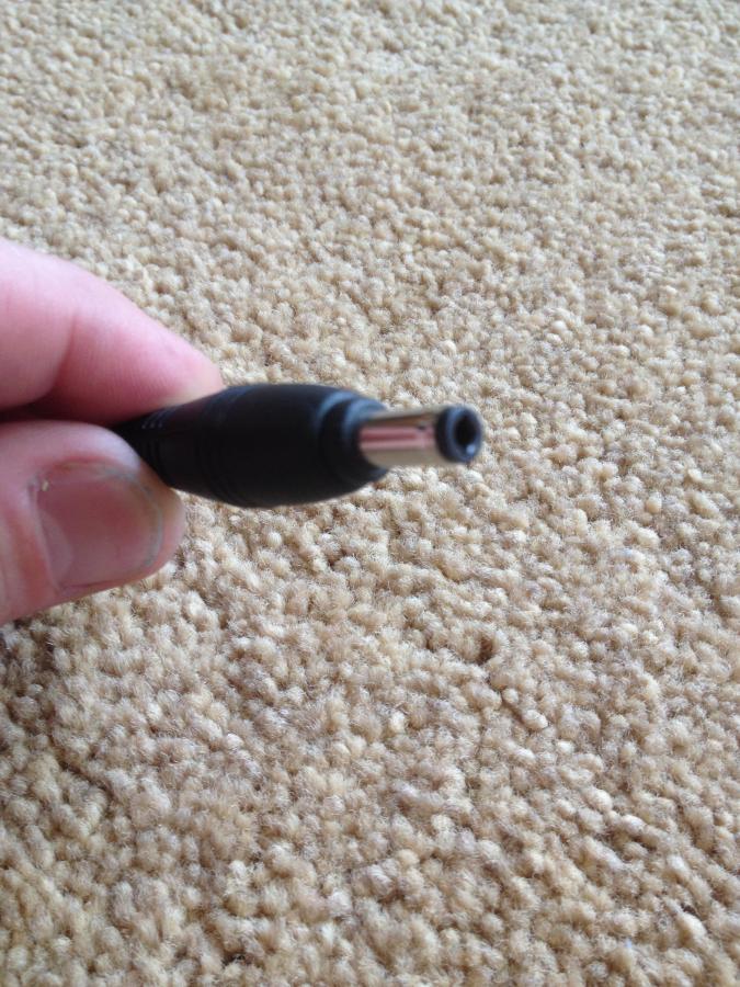

to laptop is a 5.5 x 12mm barrel to take a 2.5pin

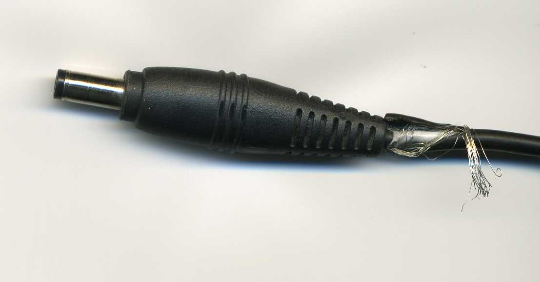

Its un repariable as the cable has split right next to the barrel plug from constantly being bent at a too sharp angle. And its an inner insulated core with the other wire wrapped around it, a bit like a coax cable bothe inner and outer insulation is split
Here it is

(28-04-16, 06:27 PM)fazersharp link Wrote: Here it is
Not a problem, I have repaired plenty of them like that. The plug you buy and be opened. Cut off the old plug strip back sheath and connect the inner covered cable to centre section of the plug and the outer wire to the outer side of the plug. I usually put some shrink wrap over the connections in the plug to ensure they do not touch and screw the cover back on. Costs less than a fiver

Yep, some you screw on like that, but that is not available in all types.
Some you solder ,some you can crimp and/or solder.
I usually use the soldered ones
But all I use shrink wrap on all.
Depending on the user, I might fill it with silicone once tested.
