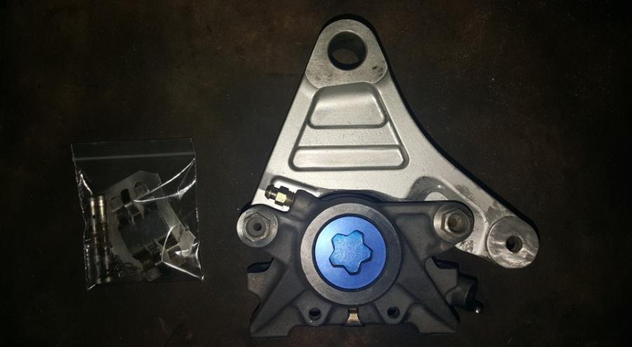

Could just fit one of these!!!
Pm me if interested, got a couple ready to go!
Looks great. Will pm tomorrow. Thanks.
Email if you want buddy,
I'm out tomorrow having my bike Ivanised by Mike....................

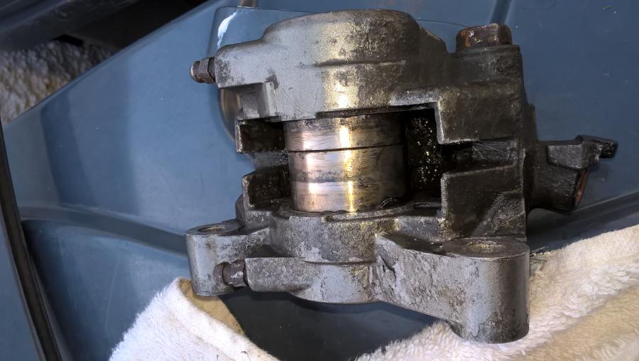

Ok. So I should have used a g clamp or zip tie?. I have ordered a fzs1000 caliper to upgrade. Best way now to split the one in photo? Will need a bench vice if am to split the body of the caliper....hate having the bike off the road.
If you don't have a vice. Lever the piston back in a small bit. Attach it back onto the bike and undo the bolts holding the caliper together. Are the two pistons moving now?
I can shoogle them a bit. I should be able to get them over the brake disc and do as you suggest thanks. One of them is nearly out. The inner one seemed pretty jammed when I was pumping the brakes that's why I kept going. Cheers.
Personally I'd push the one that's moving back in most of the way and clamp it and then use the brake pedal to push the other one out most of the way, then clamp that one and pump the other one out until they're out evenly, then split the caliper. If you split it with the stuck one still in most of the way you'll struggle to get it out without damaging the piston
