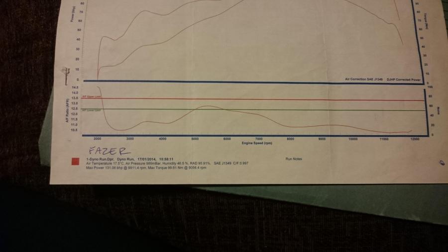

I just went from the fact that the bike came with a dyno sheet, 131rwhp. And was very rich 5000 rpm up.There is also a receipt for fitment of a standard airbox, as an owner previous must have had pods. The bike runs really nice, but is clear that it's running rich up high.

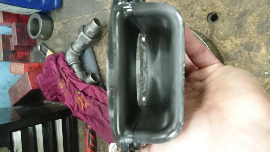

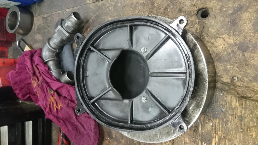

I've cut the box as per the pictures, then run a sandblaster in it pointing in the direction air should be flowing. Looks good to me Big Grin!

Not the best air fuel ratio!
I think you've been a bit rash but I hope you're happy with the results.
Do you actually know at what point in the bikes history that Dyno was taken (before / after the exhaust system, supposed pod filters, stock filter)? The air/fuel results are not what I'd expect to see with an Ivan's jet kit even with an unmodified air box, also a bike with an Ivan's kit, K&N plus full race system would be making about 140rwhp not 130, mine with a cheap end can makes 134. I kind of think you've been jumping to conclusions based on supposition which is why I suggested you check first, however you were obviously in a hurry ......................

Dyno chart looks suspiciously like someone raised the stock needles but didn't reduce main jet size.
