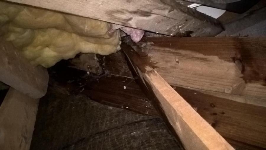

Went in to the Side attic of my dormer to get the Christmas decoration  a few days ago and saw this.
Oh Crap! Air went blue while I was in there.
The local building maintenance man tells me the wind dislodged the ridge tiles and will cost €2500 to €3000 to fix as long as the roof timbers are ok. Would not tell me what it would cost if the roof timbers are Focced. Foc, Foc, Foc  :'( Hope my insurance covers it  :rolleyes Foc, foc, foc and double Foc :grumble
Insurance assessor to contact me next week.
That must be his special Christmas rate... €2500 to cement a few ridge tiles?  :eek
No, when  he was checking the ridge tiles quite a number are loose and all the valley pointing is focced  8 tiles which had slipped in to the valley. It is going to need more than just pointing. They may need to remove the old mortor and rebed all the tiles.
The fact the roof is at a 45 degree angle and 26 foot high does not help reduce the cost :'(
L shaped dormer with 2 Valleys, a 48 foot long roof with a further 18 feet on the L section
House is 28 years old and this is the first problem I ever had with the roof.
We are up high and very exposed, so much so that Velux had to add pieces to the end of the Velux windows to prevent water being blown up through the frames. Something they only do in northern Scotland and a few places in southern Ireland.
When I built it in 1988 the Engineer insisted that every tile was nailed, not every third row as normal at the time.
Tiles rattle like a machine gun in certain wind conditions, foccing scary sh1t first time we heard it.
Looks quite recent dampness there so hopefully not penatraded through.

in my opinion the timber looks fine,

Thanks for the comments lads, much appreciated. We had Desmond and Eve to rattle the roof. Winds in excess of 60mph, highest gust near the Airport was 95mph and I am a mile from the Airport.

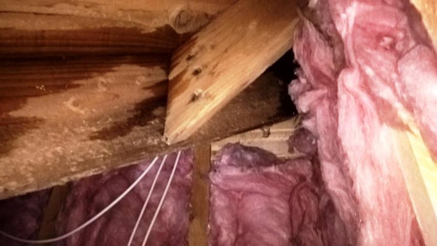

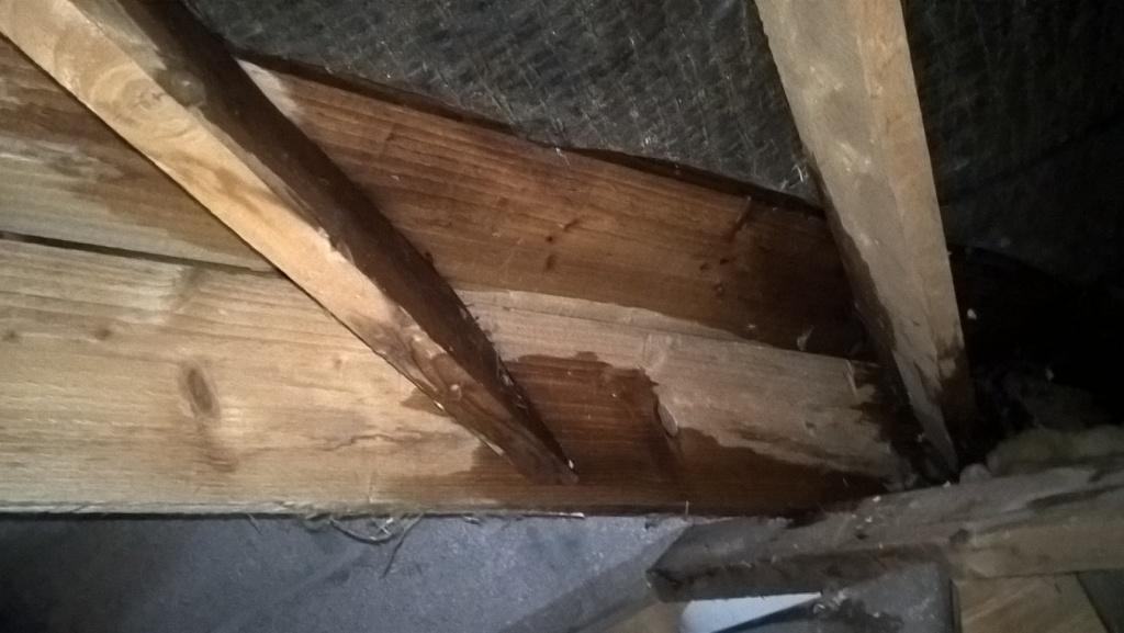

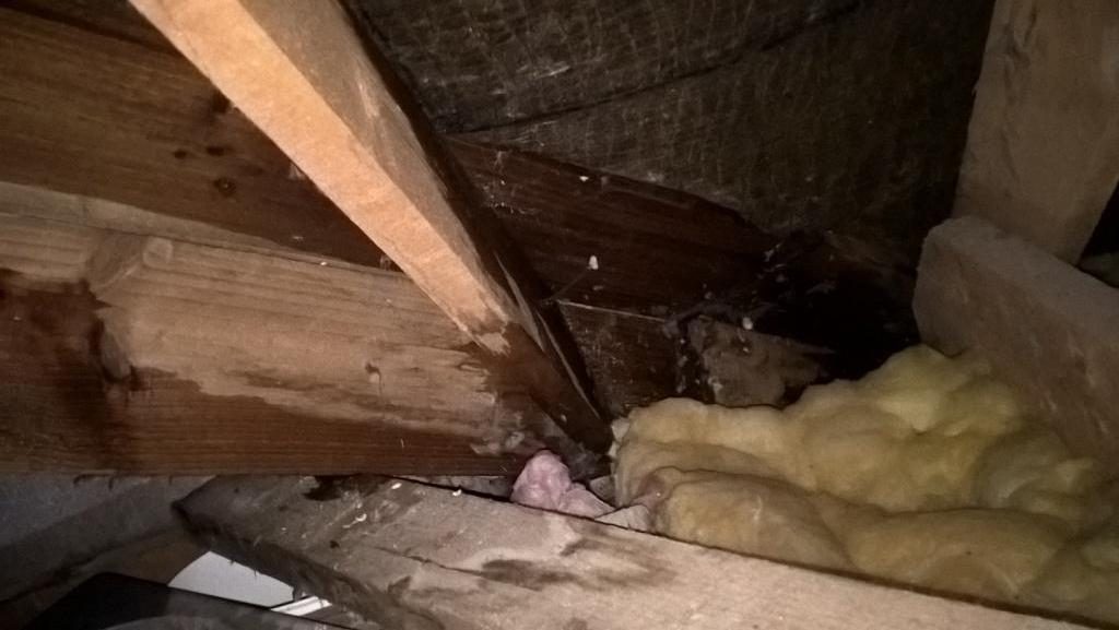

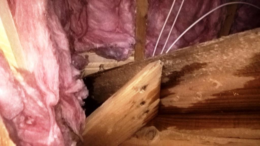

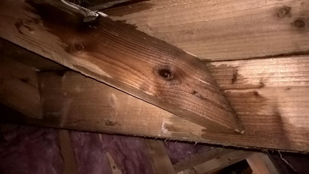

I think the timbers looked ok until I saw this, see pic, don't think it is serious but let the assesor make that call.
Diffacult to tell from piccies, but I think that will dry out ok....mine were rotten right at the ends where the guttering fixesand the water collects...I was able to trim the ends a replace with new.....good luck with your claim.
They are just a little wet - they will be fine.

The area where the Mould/Mildew is, seems solid  with a large knot which appears to be where it is emanating from. Carpenter says this would be normal with some Knots when they get wet.
