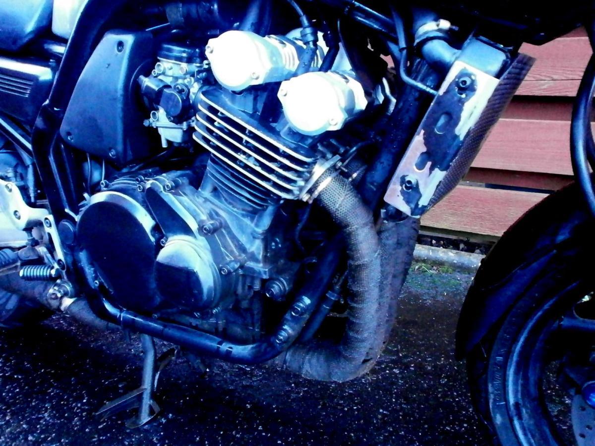

Here is a pic of it fitted to an fzs600? Is it really required on a 600?

Looks like exhaust bandage to stop an exhaust leak.
If the collector is a bit holy, wrap the whole system to fool the MOT tester into thinking you have modified your bike rather than just patched a dodgy exhaust? From the look of the brake pedal in the picture above though, I think a leaky exhaust is probably only a minor issue for that bike.

In the advert for the bike the guy says it has stainless downpipes?

(23-12-15, 12:18 PM)nickodemon link Wrote: In the advert for the bike the guy says it has stainless downpipes? Yes, it's now become a styling things you see it a lot on American retro customs and cafe racer with old Jap engines.

Looks like he has also had snapped studs to deal with, I like those stainless (looking) header clamps, the rest looks crap though
