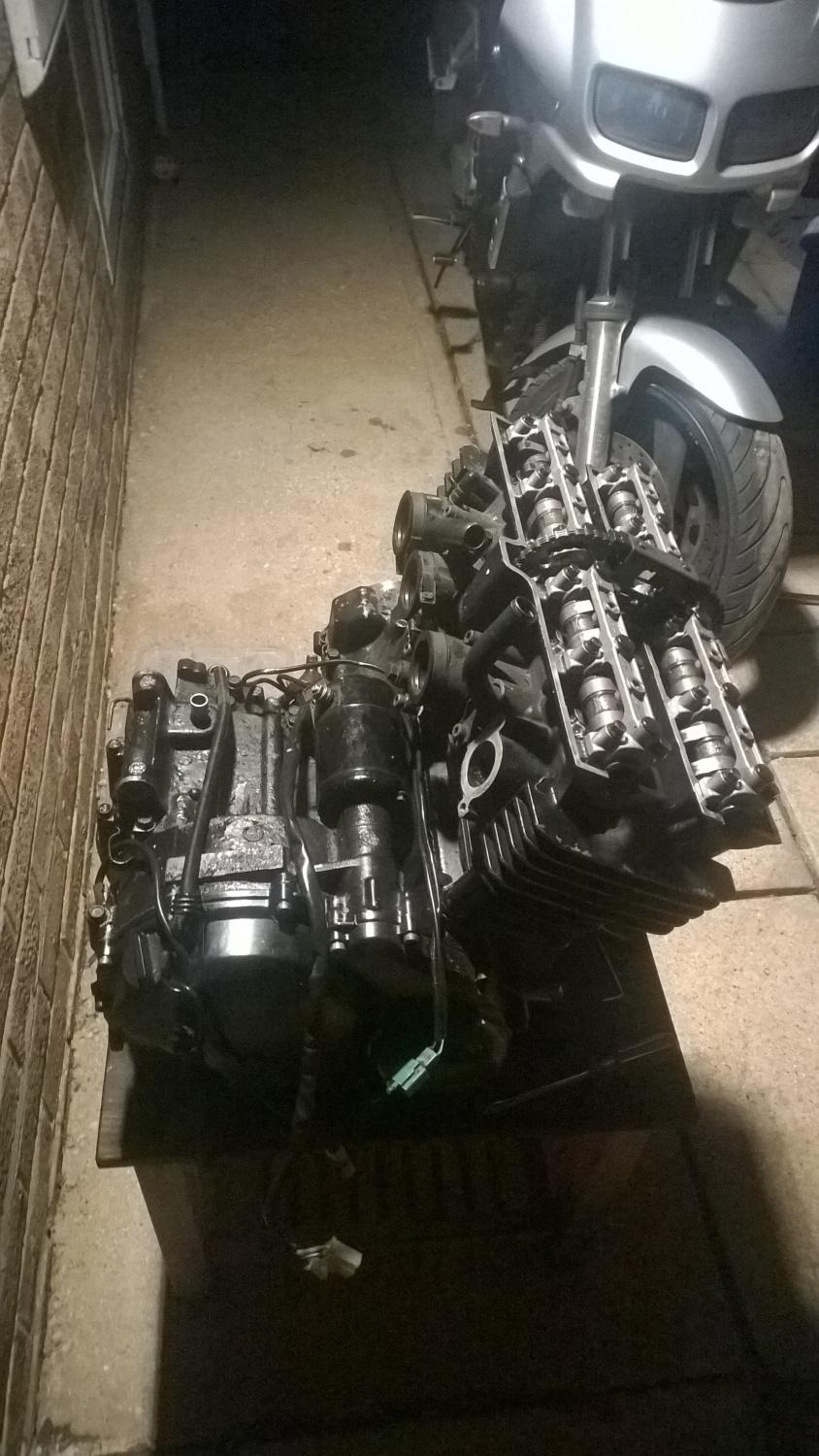

Got abit of an intermittent misfire on my 99 fzs600 since adjusting my valve clearances last weekend. Got a few working theory's about it but thought I'd get a post on here as people always have something helpful to add.
I have had the cam cover off again to triple check the clearances which are all nicely in spec. I've ordered some new plugs, seems unlikely to help but they are over due a change so cant hurt.
Main concern is my timing. In you experience how precisely should the timing marks line up on the fsz6? When I've done timing in the past on other bikes I know the marks can seem off by a few degrees. I was loosing light when doing to job so had to rush the end abit (not ideal), when the cam marks are perfectly lined up I'd say the crank is about 8mm below the mark I couldn't seem to get it any closer (do you think that's ok).

Timing marks should all line up spot on.
It's a bit of a faff, but it's easy to get things one tooth out either way, especially when the cams rotate when you tighten them down.
I don't know how critical it is for the running of the bike though.
I did mine with the engine removed from the bike and it took me about 4 attempts as I'd never done it before.
Get the crank lined up, keep the chain tight and install the front camchain guide, this will stop it jumping teeth on the crank, then fit the, the chain over the cams, then there's a combination of tightening everything, fitting the top guide and chain tensioner, and tightening down the cams without it jumping teeth.. Which is what it wants to do, as the valve springs push against the cams and try to rotate them out of sync.
I'm sure there is a technique to do it easily but for me it was a combination of trial and error, swearing and throwing tools!

They don't always line up spot on perhaps 1mm but 8mm is quite some way off I'm surprise you've not hit a piston/bent a valve or 2 which could be the reason for the misfire  :eek .
Keep us posted
[size=78%]    [/size]
Later
8mm at the crank is not as bad as 8mm on the cams (it's a bigger diameter) I guess that's a tooth out. I doubt the pistons would have hit the valves though, With the plugs out you can turn the engine over by hand, so should have checked that!
You have my sympathy though, it's a pig of a job even with the engine out! I couldn't see how you get the front camchain guide out with the engine in the frame.
Nightmare job, The cams only want to go in and out if they are square, you have 12 cam holder screws to tighten down evenly, and torque, everything is fighting you, you try and skip one tooth on the cam and it jumps 2 or 3 and you have to start again. The cams naturally want to sit 5degree outwards from each other due to the cam profile against the valve springs.
You have to line up the crank, then get the front cam on the right tooth so that when it's tightened down and the cam guide is in the place they are both in sync. Then get the rear cam in the right place (count the links between the cams) so when that is tightened down it is synced with the front cam. Then put the top chain cover on and install the chain tensioner without anything moving.
Check, run the engine through a few cycles by hand, check again. Everything should line up. If not. Start again.
The guides prevent the chain jumping teeth as they force the chain on to the sprockets. But when the cam chain tensioner is out I think the crank can skip teeth when turned by hand but only in one direction.

Being able to turn the engine over by hand isn't a grantee it's timed correctly.
One tooth out on the crank will put you in the danger zone of the valves hitting one another when the engine is started.  They only have to slightly touch and they will bend, they will bend by points of a mm but the valve seal will be destroyed and it only take one to bend and that's it game over!
Re-time the engine correctly, all the timing marks must be aligned.  Then do a compression check fingers crossed you've got away with it, if the compression is low in any cylinder chances are you've bent a valve.
Good luck.

Today I took it all apart again, managed to get the engine closed before it started to rain.
If i line up the crank shaft spot on I can either have the cam like this (slight retard):
https://drive.google.com/file/d/1h-dMyN9...sp=sharing
https://drive.google.com/file/d/16fvoibs...sp=sharing
[/size]
[/size]Or one tooth the other way and its like this (slightly more advance):
https://drive.google.com/file/d/18t3z1Fc...sp=sharing
https://drive.google.com/file/d/1nOKIpNc...sp=sharing
If i line up the cam marks dead center in both above positions I end with with the crank timing mark in either of these two positions:
https://drive.google.com/file/d/19-76bmz...sp=sharing
https://drive.google.com/file/d/1IQA12ib...sp=sharing
At the moment I have gone with the slight retard position as it appears to be closer and safer (further from hitting pistons). I have also cleaned out my carbs and they were abit gritty in the slides.
I'll test ride tomorrow when hopefully it's dry and I'm feeling less down trodden by the whole ordeal (hopefully new plugs will arrive also).
Thanks for your input all.
Not sure what its done with my post there....
There are 6 links the second one down has been compressed into a line below the first.
The second two links show the cams one tooth the other way (it cut out my text explaining that).
Hope that makes sense.

Make sure there is is no slack in the in the front portion of the cam chain.
What you appear to be getting can be a symptom of that, all the slack must be at the rear.

I'm in east Bristol. I've been making sure the engine turns over freely before putting it all back together and starting it up. Yes the street isn't ideal.....
Further to the front of the chain tightness point. When you tighten everything down and rotate the crank ccw that tightens the chain at the front, the only other variable in this is the number of chain links between any two given points on the crankshaft and ex cam sprockets.
Perhaps if I went with the advanced timing option shown in the pictures (links) and gave it a run and let the tensioner really clamp down it would tighten the chain enough at the front to be perfect?
Mate you shouldn't have to move anything it should all line up with the slack at the rear which the tensioner will take up.  If you can move the crank or cam with the chain in place and it doesn't move the chain is buggered there should be no play in the chain?
Later
Just taken it for a ride (first since yesterdays rebuild) and it seems to be running perfectly!
The timing is where is was before, I think perhaps the chain is stretched a little and ill have to keep and eye/ear on it but sounds sweet for the time being.
I did clean out the carbs which were quite gritty in the slides. perhaps when it turned them upside down whilst struggling with the throttle cables all the crap from float boat ect ran into the slides? Or anyone of another 100 possibilities....
