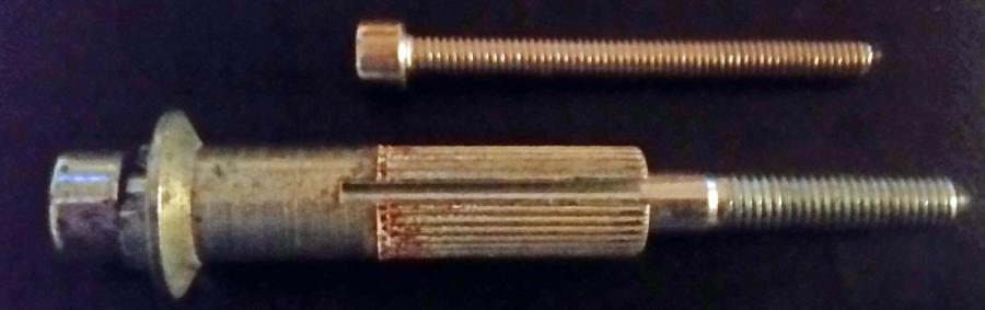

I'm having a similar problem atm with the acerbic handguards on my DRZ.  Have you got a photo of the guards and bar end bolts and have they got the cone insert that expands inside the bars. ?
Picture of the bolts would be helpful.

The bolt on the top is the original one that was holding in my bar end weights, and the bottom bolt is the one that is supplied for the hand guards, considerable difference in size. I've checked for the hand guards coming into contact with the wind screen & they do but only very marginally at full lock so not really a problem.

Whats the bolt length and size, everythings out there if you look in the right place.
Dave Middleton has m8 socket caps as long as 150mm, not cheap admittedly but should be able to find what you want

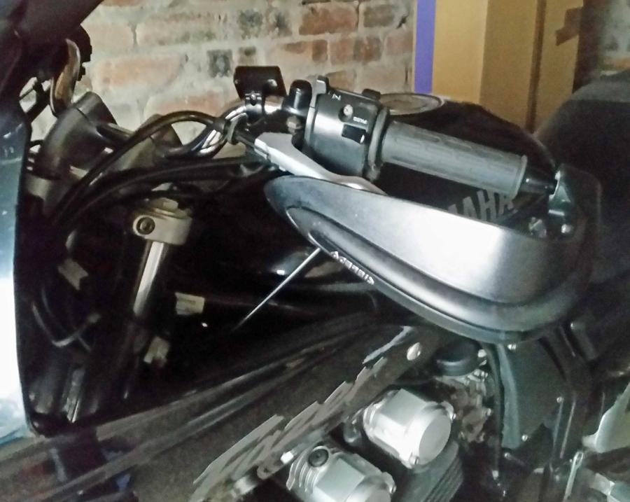

Managed to get longer M6 bolts from B&Q..the hand guards are now on but now just need to severely tighten them to make sure they are totally secure & don't move about

Let's see what they look like then  Smile
Will get a pic up asap..

Trying to post a pic but it won't let me..???
Pic (hopefully..!!)
thanks  how much do they hit the fairing and where, can you take a pic of that please
They just clip the fairing on full lock, but the guards seem fairly pliable so don't see it being a major issue. Will try to get a pic when I'm next in my lock-up
