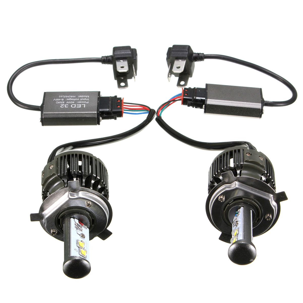

im tempted to try out the leds with drivers  like this
[Image: D513039B23C846C85365D22656CB9ED2C9263499...93A0CD.jpg]
but not to sure.
