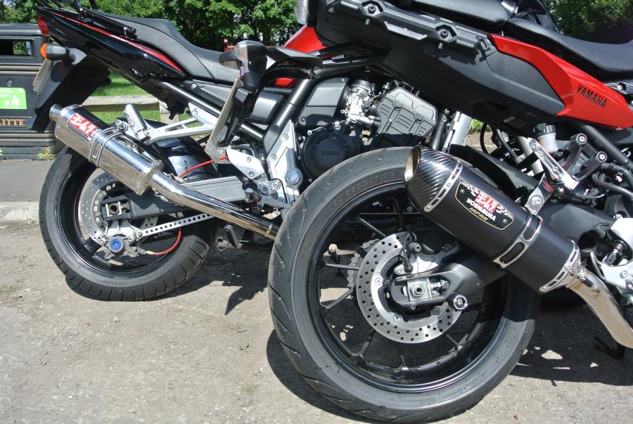

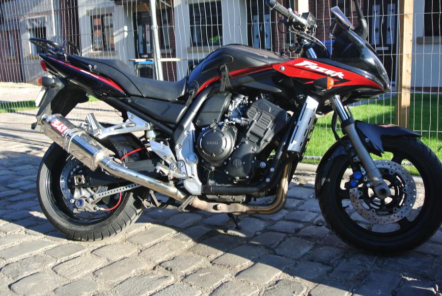

Hi just bought a new Yoshimura tri-oval end can,fitting instructions are simple as per usual but at the bottom it says to drill 4 7/8" holes in the airbox lid?
Don,t like the idea of drilling holes in the top of the airbox but it says to do it so should I?

i have one of those, cut 5 inch off it it looks much better Smile
i havent drilled the air box but the bike is ivanised runs better with the cut down yoshi than the akra i had on before.
Hi got a little too inquisitive about the holes in the airbox and drilled them,oh dear!!
Seem to have lost a lot of midrange grunt at the benifit of top end revving which I dont like  :'( think I,m gonna get a new airbox lid  :rolleyes .
Ps Bobdog how did you shorten the yoshi?

just drill the rivetts out on the link pipe end, i cut 5 inch off redriled and riveted it back on  Smile
