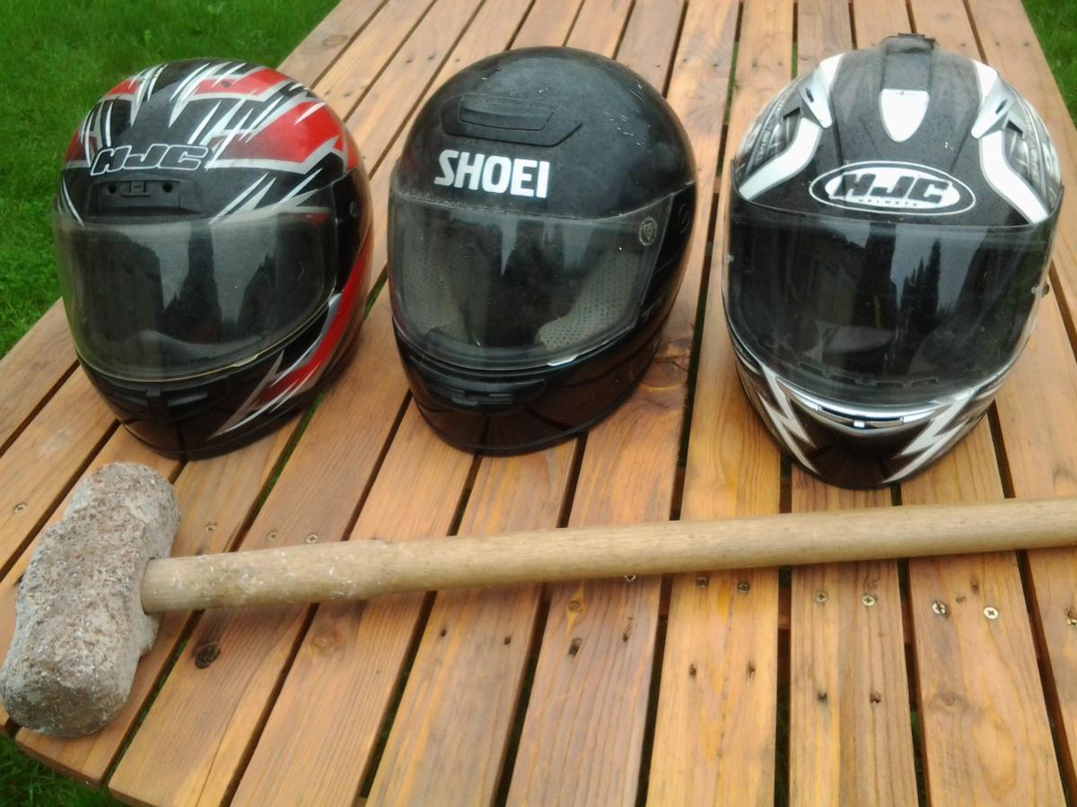

Three helmets.....shoei txr july 1996.....hjc zf7.no date just batch no, estimated 2004......hjc is16 feb 2012

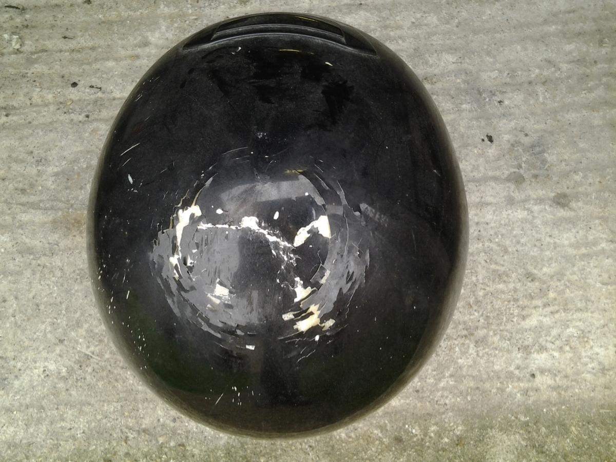

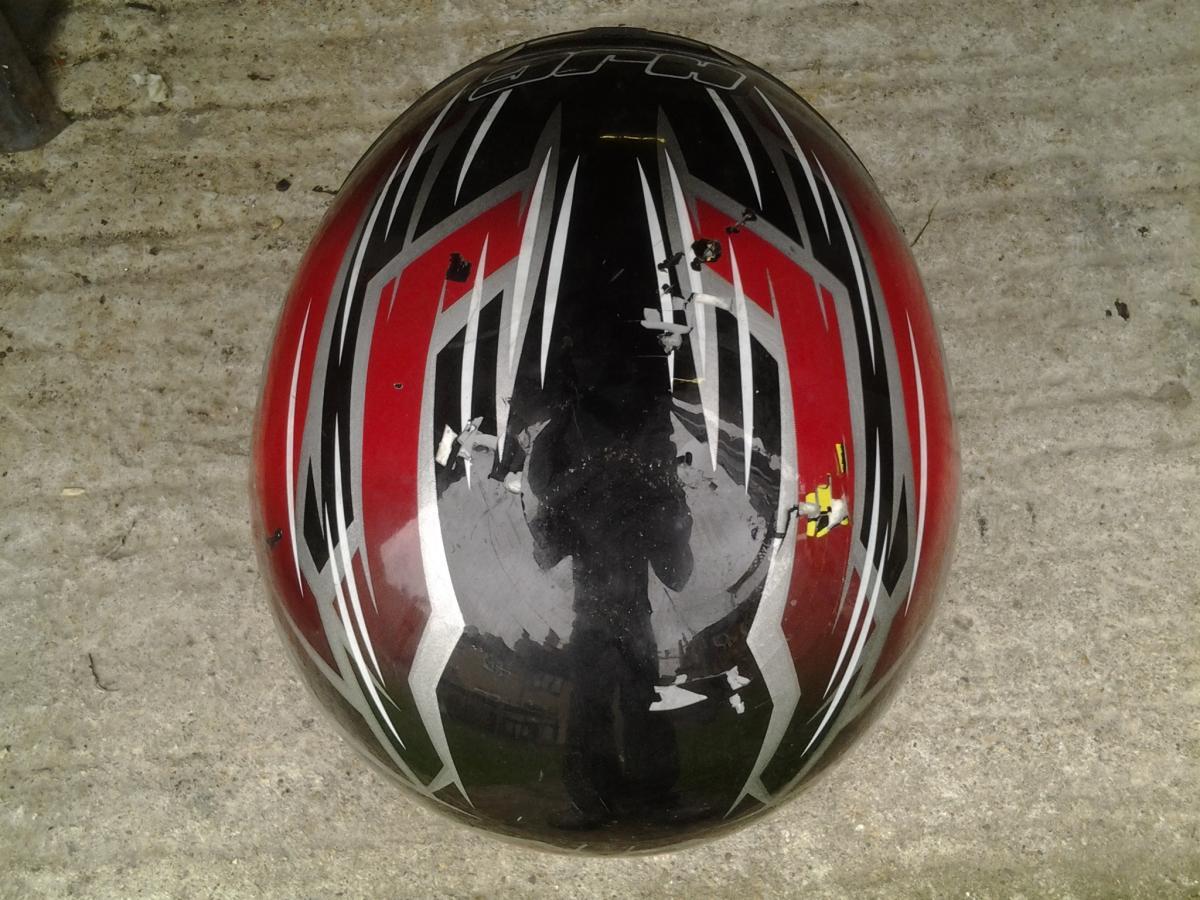

First test using my biggest adjuster weighing in at approx 20kg, dropped on helmet from head height, just the weight of the hammer, both the shoei and zfz crack the top coating/ paint but are in one piece, is16 does a bit better, just a scuff mark and no cracks to th paint.

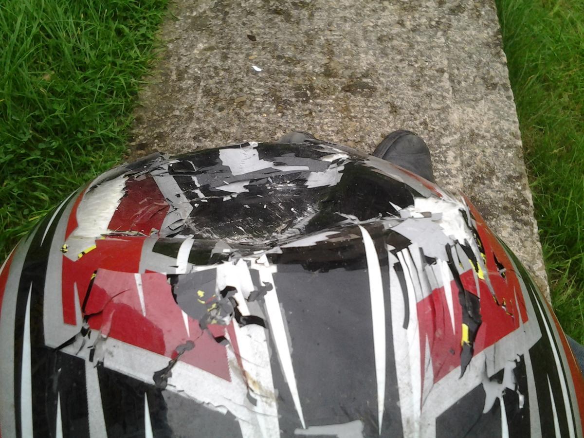

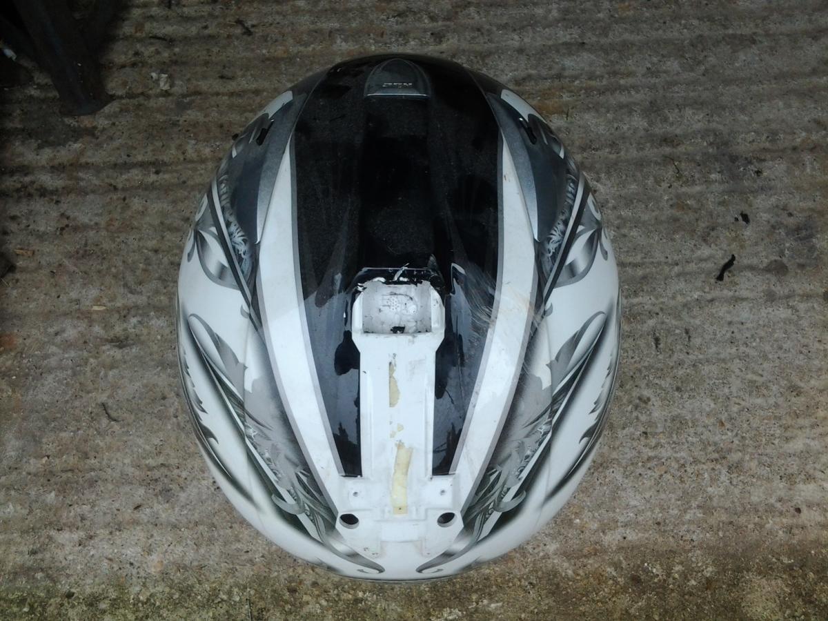

Live testing    :lol.........little bit harder this time, head height again but with a bit of welly.........getting some funny looks from the neighbours now  :lol...........shoei has a small crack to the fibreglass and more cracked gel/paint all over not just the point of impact,,zf7 doing a bit better, more flaky paint but just around the impact area, is16 is interesting, the mechanism for the internal visor broke on the first impact, expected, paint still intact, but, hammer bounced back and helmet made a run for it  :eek could see the helmet flexing, did'nt notice that on the other two, flexed enough to pop the inner padding out.still looks pretty good on the outside though........TBC ,got to do a little warm up for the next one, ppe please  :lol

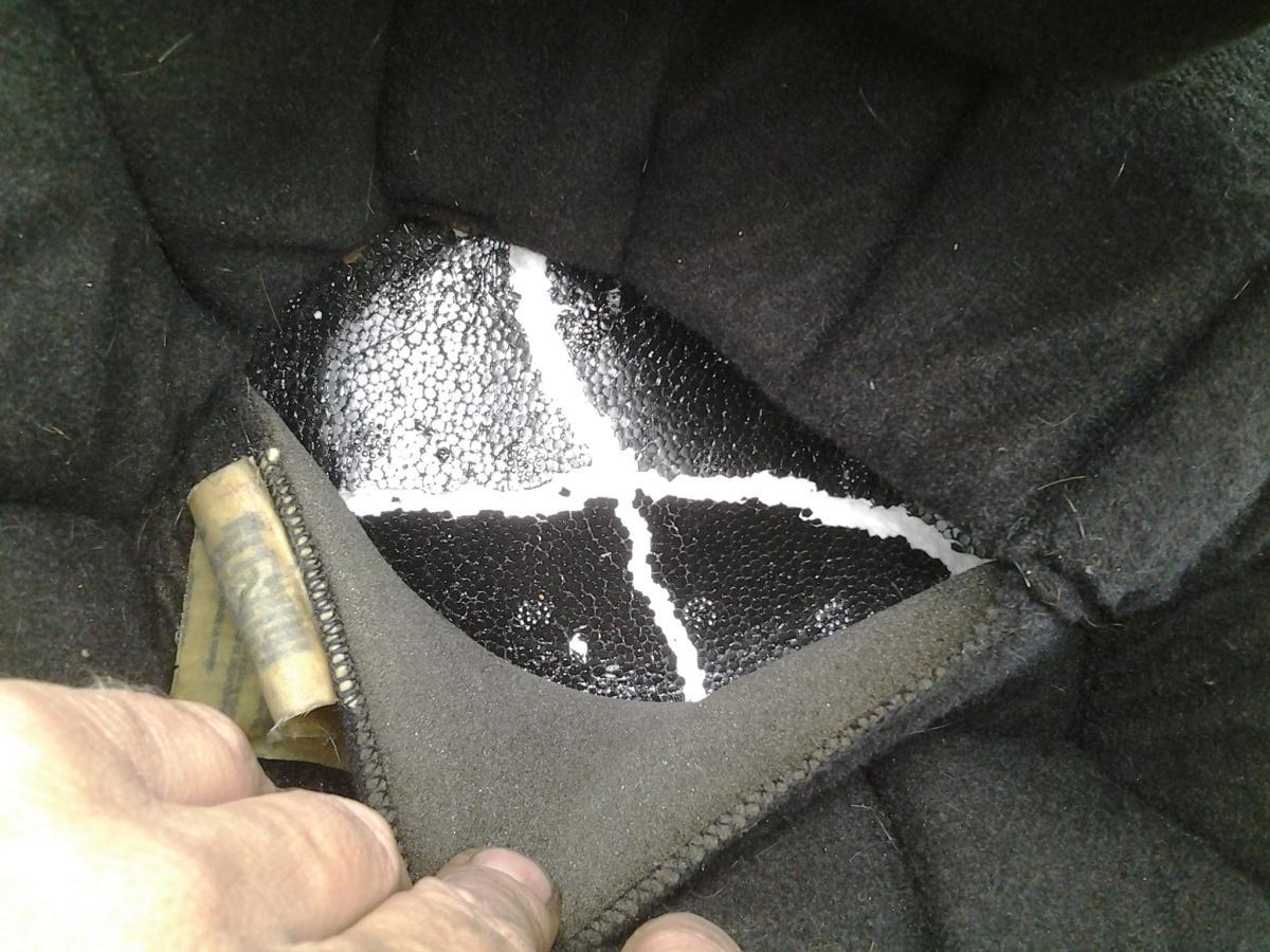

Shoei 0 red98 1.........good swing of the hammer, not quite flat out, broken through the fibreglass and split the inner polystyrene....this is the oldest of the three by at least 8 years........NEXT...

Zf7......got a more central whack on this one, more of a dent, cant see any cracks in fibreglass but it is hairy in places, good cross break in inner polystyrene.......Next
