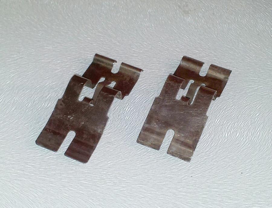

The pads in the left hand caliper have very small movement backwards and forwards in the caliper and by this I mean very small amount of movement but with the front of the bike jacked up off the floor if you turn the wheel back and forth then you can just hear the pads move slightly. You can also see on the inside on the caliper where the pads have worn a very slight channel into it. I have found a link to an old thread on the old site about how to modify the spring retainer for the pads to make them sit hard against the front edge of the caliper to eliminate this movement and will probably try that tomorrow.

You modified your pad retaining spring didn't you? Got any pictures?
Chris

I did do the mod, but it obviously didn't help at all, and just becomes a real pain getting the pad pin back in, it's really tough to do.
It would help if your pads were chattering because they are ill fitting in the caliper, but otherwise the mod is unnecessary and won't help you.
