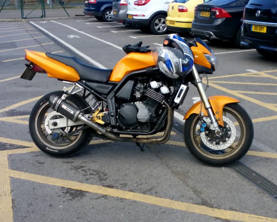

[color=rgb(51, 51, 51)]Really stupid question im sure. [/color]
[color=rgb(51, 51, 51)]But anyone have one of them friends who can so sneaky under the table MOTs?[/color]
[color=rgb(51, 51, 51)] mechanics are not a fan of my headlight and i cant get it to pass.[/color]
[color=rgb(51, 51, 51)]If you know someone or can your self please email me and name your price.[/color]

What reason are they giving for not passing it?

when I brought the bike it had non of the original fairing or headlines the wires have already been cut and soldered so going back to the original would be a long and expensive process.
another issue is my bike is stored in my friends garage in Brighton while I'm stuck in derby.
I know my bike is safe riding condition otherwise I wouldn't drive it. just  finding a mechanical that will give a bit of leeway with Chinese headlight

Presumably it's failing on dipped beam shape or otherwise causing dazzle to oncoming vehicles so it needs to be sorted out.
If you can't do that where it's currently kept, disconnect the lights and tape over them, get a Daylight Only MOT and ride it home.

well my lights are not the best. before I had bulbs with a very dull yelow glow. like a 1950 vespa. I have some blue bulbs they fix the dull issue but Im not sure I could pass with them anyway. I had an offer for a no question asked mot for 75 quid but they pulled out in the end :/
What type/make of headlght/fairing is on the bike and what type of bulbs does it take?

I'm assuming someone in the past has streetfightered it. If it has a standard round headlamp get on the net and get a replacement headlamp for a super dream or the like. It'll be around £30, H4 halogen and will be a piece of piss to fit. It'll be 10 times brighter and will fly through an MOT test. Cheaper still , visit a bike breakers and get it cheaper. Hope this helps. Good luck.

Is it the dipped beam pattern that's the problem? Kicking up to the right?
If you can work out where it should you can mask off the problem area on the outside of the lens with insulating tape.  It is acceptable for MOT as long as it gives horizontal dipped beam pattern, left hand drive cars pass UK MOT with beam deflectors stuck on lens.
