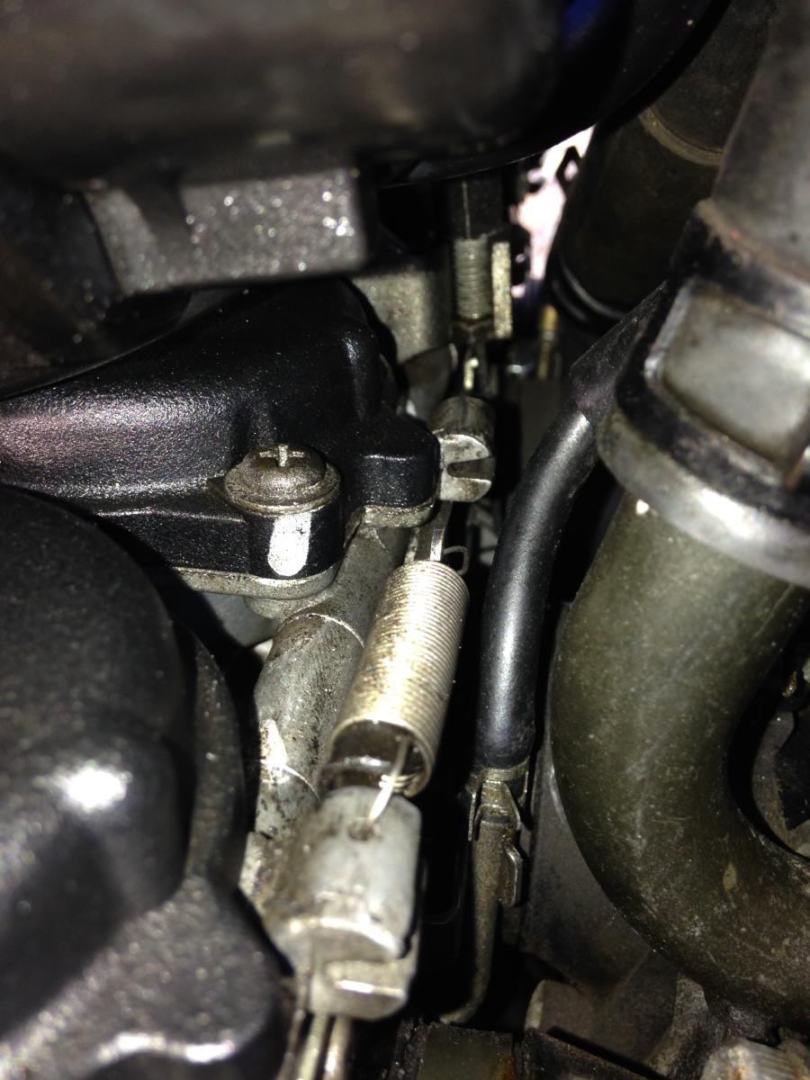

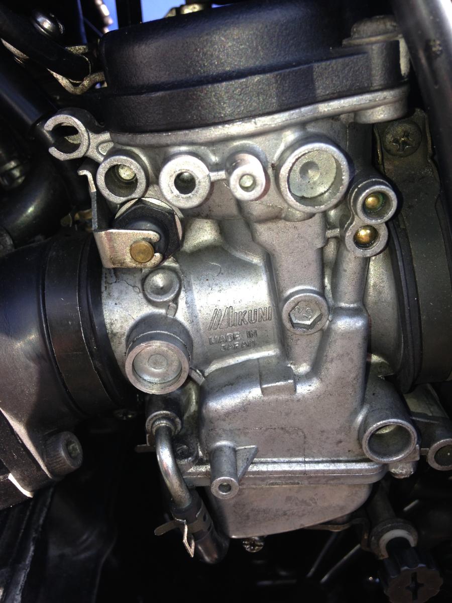

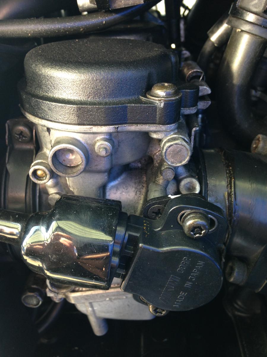

Hi all,
I booked my bike in last week for a carb clean as i have owned the bike for a year and didnt know the last time it was done, the garage said he was going to put the carbs in a sonic carb cleaner and this would give them a better clean than just a strip and clean.
Although now i have the bike back it seems to be runnign worse than ever and when i looked at the carbs last night, the exterior didnt look all that clean, almost the same as before, but when i looked up on youtube for sonic cleaners the carbs they cleaned came out pretty spotless?
So my questions is, should they be clean on the outside also? or do you think the garage has pulled a fast one and just done a small amount of cleaning and charged me for something hes not done, especially as its running rough and now barely idles at 1000 - 1250 rpm and have to keep it around 1500 to tick over properly without sounding like its going to cut out.
Have attached a few pictures to show current condition of the carbs.
Thanks
Sounds like they need balancing, do they look like they've been stripped at all- as in do all the bolts like they've been removed, ( I can't see pics on tapatalk app!) their version of a sonic bath might be just about cleaning the internals using this method!
You've used a professional so take it back to them and explain that it's running worse, please sort it!

But looking at the pictures (which you cant see) there is still a fair amount of dirt on the outside and i found an older picture i took last month and compared them and the dirt matches and when i rub it with my finger it comes off so surely a sonic bath would remove this?

If your carbs had been removed and cleaned in an ultrasonic bath they should be spotless, certainly no dirt on them even if all surface corrosion isn't removed.
Have a look here: http://www.pakwheels.com/forums/attachme...-carps.jpg
They certainly wouldn't be able to clean just the inside and leave the outside dirty. Sounds to me like they've just run some carb cleaner through them and they're just bullshitting you!

I had a good look at the carbs at lunch and they are pretty dirty on the outside, i cant see how he could of removed them and not given them a clean to at least make it look like he had worked on them?
The bike is certainly running worse, so i am not entirely sure what he did, and because he is not back until the 13th i have just got to wait, but as with most people on here, you get to know your bike and all its noises and issues and its definitely not right.
What he will do about it remains to be seen and whether he will resolve the problem is another? but there are a few other garages by me, one being a Yamaha main dealer (which i would imagine is going to be expensive) and a few other small places.
