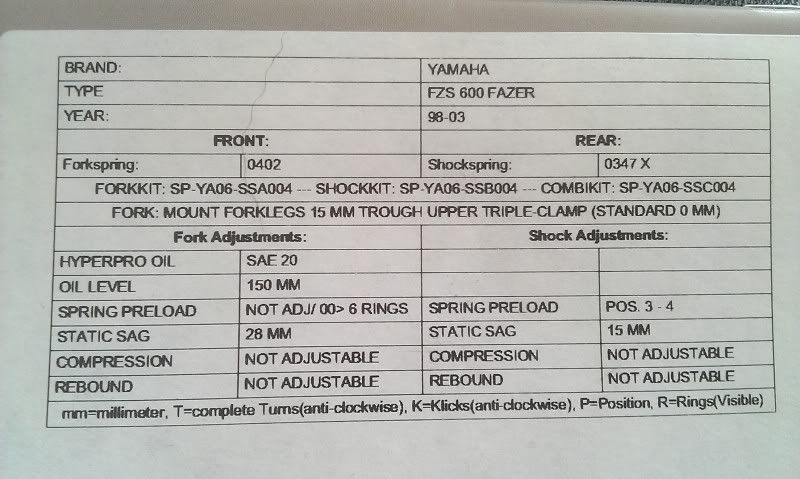

My bike is fitted with Hyperpro springs front and back and the yokes are supposed to be dropped down the forks by 15mm to return the front to it's standard height.
The kit was fitted by the previous-previous owner (one of the lads on here) and he bought it as a set with oil included I think.
Anyway, here's the chart that came with the manual
[Image: IMAG1049_zpsa363ca0d.jpg]
yes remember the 15 m. see pic.

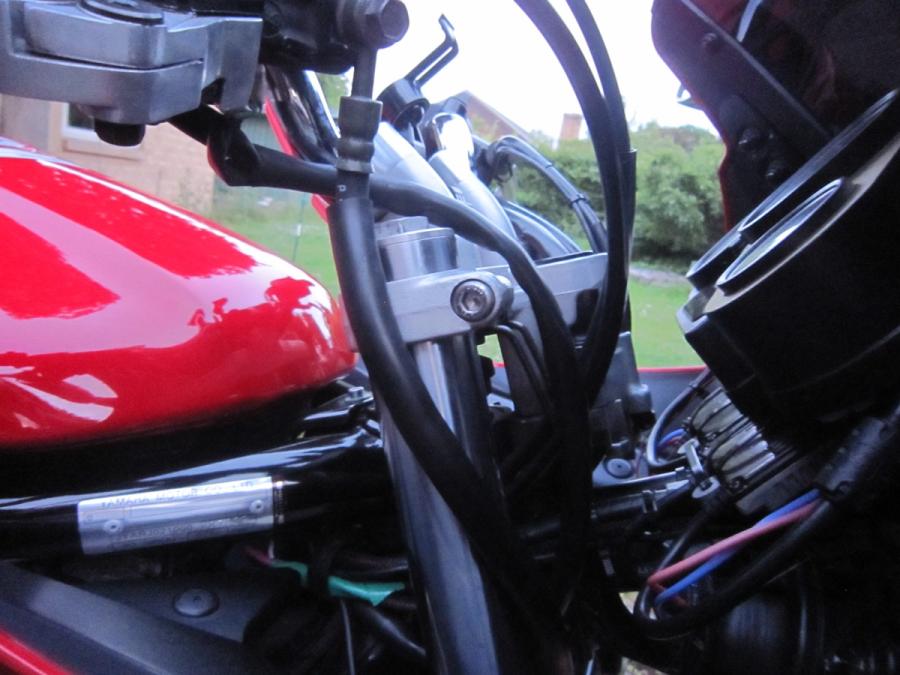

(25-06-15, 01:13 PM)Bimbam link Wrote: yes remember the 15 m. see pic.
I really hope you just mistyped there Bimbam :pokefun 15m?
But seriously,  why this 15mm drop on the yokes or rise in the forks, whatever way it's put, why does this make any difference?  Does anyone know?
Colin
(25-06-15, 06:13 PM)sinto link Wrote: [quote author=Bimbam link=topic=17439.msg201079#msg201079 date=1435234431]
makes turn in sharper etc
in other word alters steering angle rake etc
im running vfr springs, eliminators, 17/18wt oil 100mm air gap,fork through yokes 20mm(thats co im currently running 70 series tyre)
bikes well balanced and stable at speed  not too twitchy  ( but im not worried about front coming up) has transformed handling alot no more running wide in corners  Smile [size=78%] [/size]
waters wet, shit stinks !
I know of it turning in quicker, I'm more intrigued to find out why people are saying "you have to have the 15mm"?
You can have them anywhere you really want to surely? Providing both sides are equal and it's not obstructing anything else,  it's then down to personal choice and preferences which you only get with trial and error, what suits one rider won't maybe suit another? Smile
Colin
It's probably just to get the ride height back to standard, they could've said cut 15mm off spacer but that would mean losing 15mm of fork travel.
What surprises me is they are quoting the same for all ages of Fazer when the Yamaha spring length is different on models with or without preload adjusters.
