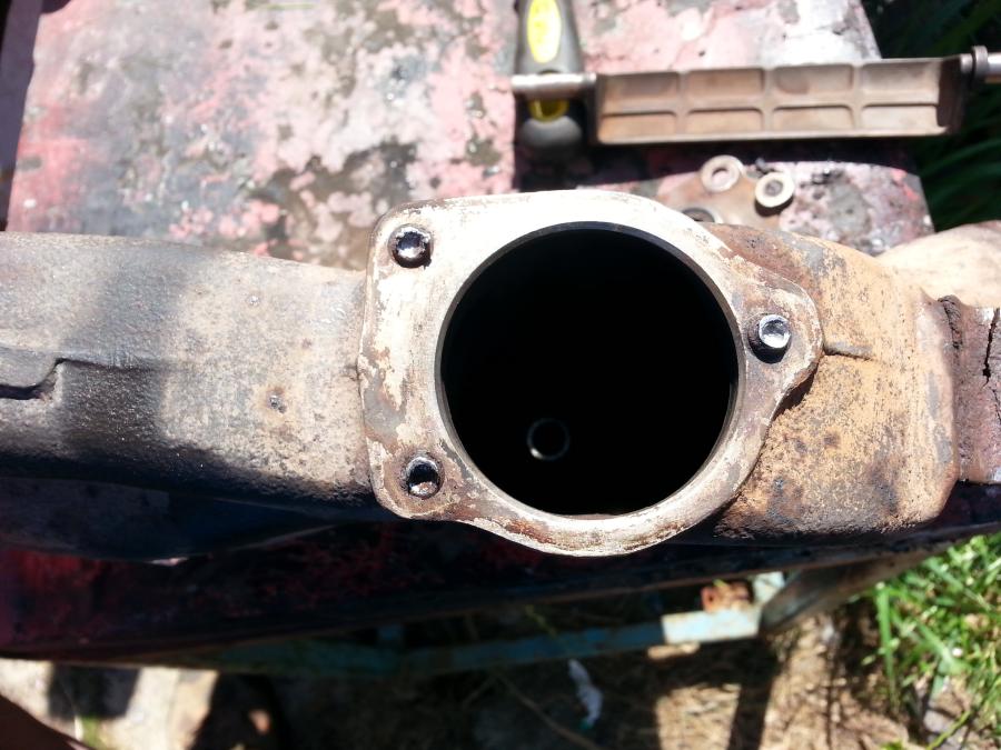

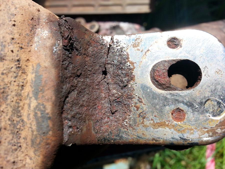

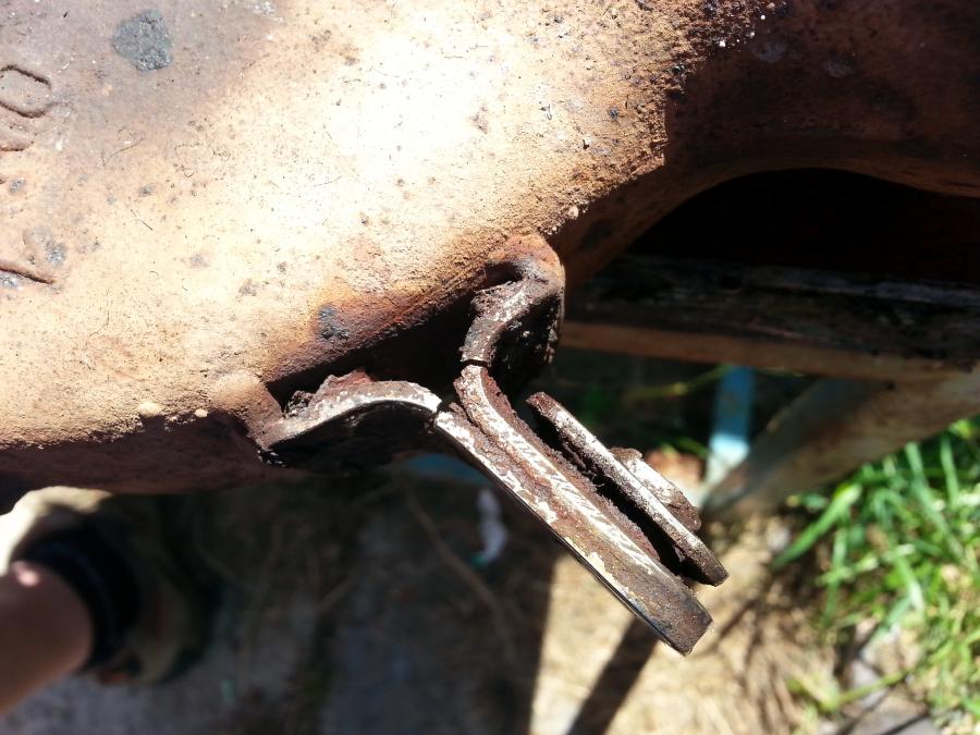

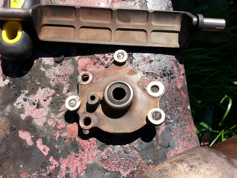

Managed to get a few pics of the fooked bracket etc
another
exup bolts
one more
Just an update, had the bracket welded back up and all the snapped bolts sorted out, EXUP valve is all greased up and guess what, the vibes have all but gone  :lol  I will still balance the carbs up just as a matter of course but for my bike at least it looks like the vibes were down to the snapped bracket.
