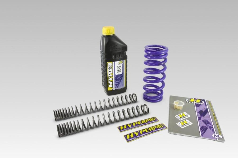

Just got new Hyperpro springs in my front fork and on the rear damper. It is a complete kit, and its working very good.
http://hyperpro.com/en/
Now it is at magic carpet ride!!

(20-06-15, 05:57 PM)Bimbam link Wrote: Just got new Hyperpro springs in my front fork and on the rear damper. It is a complete kit, and its working very good.

Hi Sinto. I live in Denmark and got it from The Scandinavian dealer.
It is called a Combikit. : SP-YA06-SSC004. And the price was 2.100 Dk = about 280 euro.
It is like a new bike now  Smile

Hi. it was pretty easy. Just read the manuel. Remember to mount the front legs 15 mm higer up. (it is in the manuel)
In my opinion, the small bumps are better than before and the big/hard bumps dosent rock the bike.

Hi. The 15 mm is printed on the front site off the manuel that comes with the kit.
Please be careful, when you chance the spring on the rear damper.
