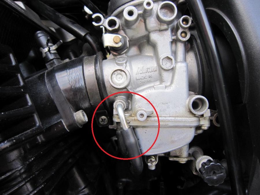

Hi.
My brother got a leak on a coolant hose (See picture)
We have replaced the hose and now it is working fine.
My question is: What does the coolant do on the carbs?
Bye the way, the inlet rubbers on the carbs dont look good, is replacement needed?

As far as the coolant on the carbs, it's just water based if you've mixed it with anti-freeze etc, a good wash will get rid of any residue providing it's just the outside of the carbs, i.e. the casing? that it went on.
The rubbers do look iffy, I'd certainly change them.

I take it you mean why is there coolant going to the carbs. I can't say for definite but some manufacturers do this to prevent carb icing.
The Venturi effect of the jets/carb intake sucking in air can cause ice to form and cause fuel starvation. The water jacket in the carb will warm it to stop the ice forming.
As for your rubbers, yep, I'd definitely get some new ones
Steve
I never knew what that hose was thought it was some sort of breather.
The rubbers look fine --- in that nothing to worry about yet as they are only very fine cracks and will need to get much much worse before the cracks are all the way through
There is supposed to be a small spring type hose clip on that pipe like the one on the small pipe on the right side of the radiator.

It's called the "Carb Heater Circuit" and is designed to create a bit of heating by channeling hot coolant around the outside of the carbs to try to prevent the effects of carb icing in winter (or summer in the UK :rolleyes ).
My bike suffered from it when i first got it, but fortunately when i phoned my mechanic when i was stranded by the roadside he knew the symptoms that i explained and he told me what it was.
You're better off Googling or YouTubing it for a better explanation than i could give, but with me i'd leave home for work and about a mile up the road in exactly the same spot my bike would suddenly run very rough, and i'd have to pull over and keep the engine running by revving it as best as i could.
The heat of the engine would then melt the ice in the carbs and i could then be on my way, but that could be a good 10-20mins later so was a tad annoying, and embarrassing.
It was a more common occurrence when there was moisture in the air and the temperature was roughly between 0 to 5 degrees.
I tried buying the recommended treatment, which was a cap or two of Silkolene Pro FST but that made no difference whatsoever.
Then after a bit of research i found that a lot of people used 99% Isopropyl Alcohol in their fuel tank as a way of combating the problem, at around 1% of the fuel tank size, so a 20 litre tank would need 200ml.
Not only does the alcohol lower the freezing point, but will also bind with any water/moisture in your fuel tank and burn it off as fuel.
I still use it every 2 or 3 tanks of petrol during winter just to keep the tank moisture free, and it makes no difference to the performance of the bike plus does no harm to any pipes, etc, as it's so diluted.
Those carb heater pipes are very thin though and the channels have a reputation for getting clogged up (so my mechanic tells me) so it's another good reason to try and have a well kept coolant system.
Doing a proper clean out using Radflush every 12 to 18 months will certainly be a major benefit to the engine and prevent clogged waterways which in turn causes overheating and then more serious problems.
A good working airtight coolant system shouldn't even need to be touched, and the coolant level in the expansion tank should be the same more or less every time once the bike has cooled down, although you may lose a tiny bit in very hot conditions.  Smile

Mine also suffered from the carb icing misfire and the Silkolene fuel treatment also had no effect. Got used to it ( only a problem when starting from cold in sub zero conditions, no problem once bike was garaged) and knew once misfire started just had to stop engine for a minute or so and problem gone till next cold start.
When o-rings on coolant pipes exiting the back of the cylinder head started leaking had to take carbs of to replace the o-rings and found the carb heater pipe blocked. Managed to blow them clear with a footpump without dismatling them.  Once everything was back together again the carb icing misfire was gone.
Checking the way the pipes connected the carb heater only has coolant flowing through when the thermostat is closed.  This avoids the carbs being heated to 80 or 90 degrees once engine warmed up

the 1st pic posted of the coolant tube is actually not the main one. that is just share the coolant from carb 1 and 2. see in the pic carefully slightly on the left there is another hose coming out....that links 2 and 3. and from carb 3 another hose to 4.the 2 main hoses that supply the coolants to heat the carbs are one on the right side the other i think on the left but more inner.
