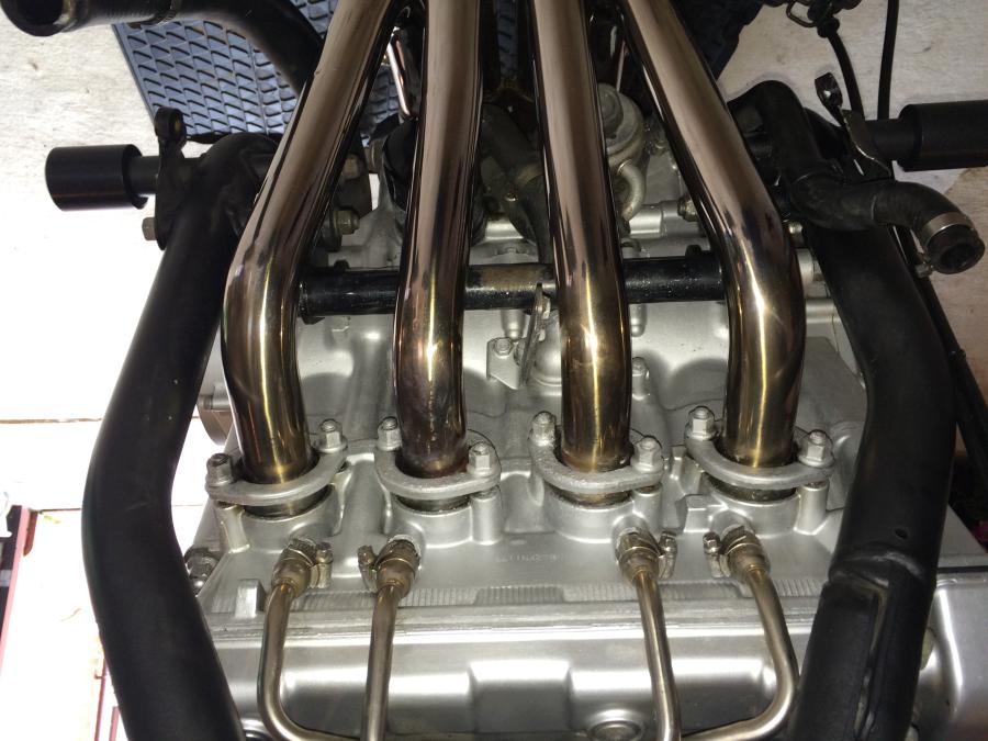

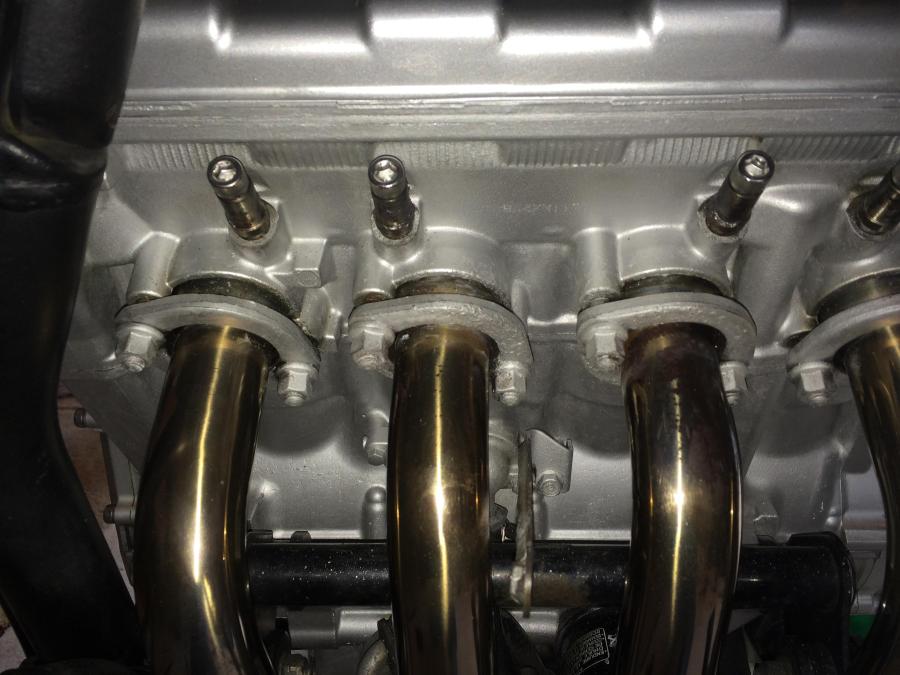

Repainted mine a couple of years ago , I cleaned the engine with engine cleaner , removed the loose bits with sandpaper , lightly rubbed the engine down , used Simonez is aluminium engine paint , doesn't need priming , I reckon it will be good for a couple more years , I did remove the radiator , downpipe , sprocket and air filter covers beforehand and used loads of paper and masking tape .
I would not be grit blasting my engine with all of those holes leading to the internals. I know somebody who had an old Gardener engine and did exactly the same as you intend. He sealed all the holes, or so he thought. Guess how long the engine lasted when he started it up? It costs thousands for a strip down.
hi OLD SON......just going to blast the covers off the bike,then a good flushing with gunk and an airline  Wink ..then do as ESETEST ,with the rest of the engine ...

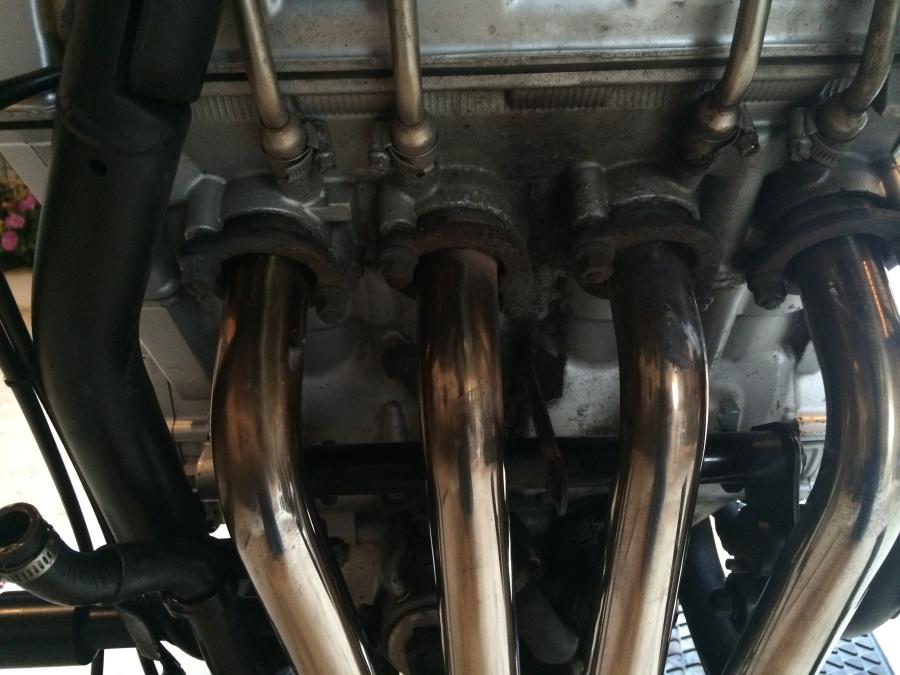

I did mine while the removing the induction system thingy......cleaned it down with an anti greaser, lightly sanded off the remaining crap and used Simoneze Aluminium high temperature paint....came up a treat
That looks good BBB.....painting the exhaust clamps was a good idea, mine are in a terrible state  :\
here's when i did mine. like any painting work it's time consuming to get right but it still looks good today... the thread turned into a sheared stud removal debate for while but essentially it's engine painting.

is it clean enough?
WOW.....nice work BLUDCLOT  :thumbup.......mines not going to be that good, its in a far, far worse state than yours  :o
