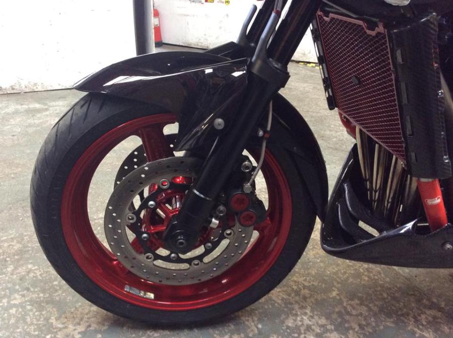

Can you buy red coloured caps to replace the blue ones or is that why they are called bluespots?

(20-04-15, 09:35 PM)sinto link Wrote: Can you buy red coloured caps to replace the blue ones or is that why they are called bluespots?
red spray?
On anodised metal? Wouldn't it look rubbish?
Colin
colour anodise them yourself?
Paint would be ok wouldnt it as they are out of harms way and not going to get touched by anything.
And why are they blue, was it that these are or were OEM on the R6 which was blue, and to keep costs down they just kept them like that

(20-04-15, 11:03 PM)sinto link Wrote: On anodised metal? Wouldn't it look rubbish?
I think mine look ok.

(21-04-15, 09:31 AM)Mick-H link Wrote: [quote author=sinto link=topic=16688.msg192241#msg192241 date=1429567406]
They look better than ok mick-h, could you tell me how you done them please?

(21-04-15, 10:40 AM)sinto link Wrote: [quote author=Mick-H link=topic=16688.msg192269#msg192269 date=1429605108]
Sent them away to be anodised.  Smile
(21-04-15, 01:17 PM)Mick-H link Wrote: Sent them away to be anodised.  Smile
Ahh right, wee note taken for a winter project I think, cheers Mick.
