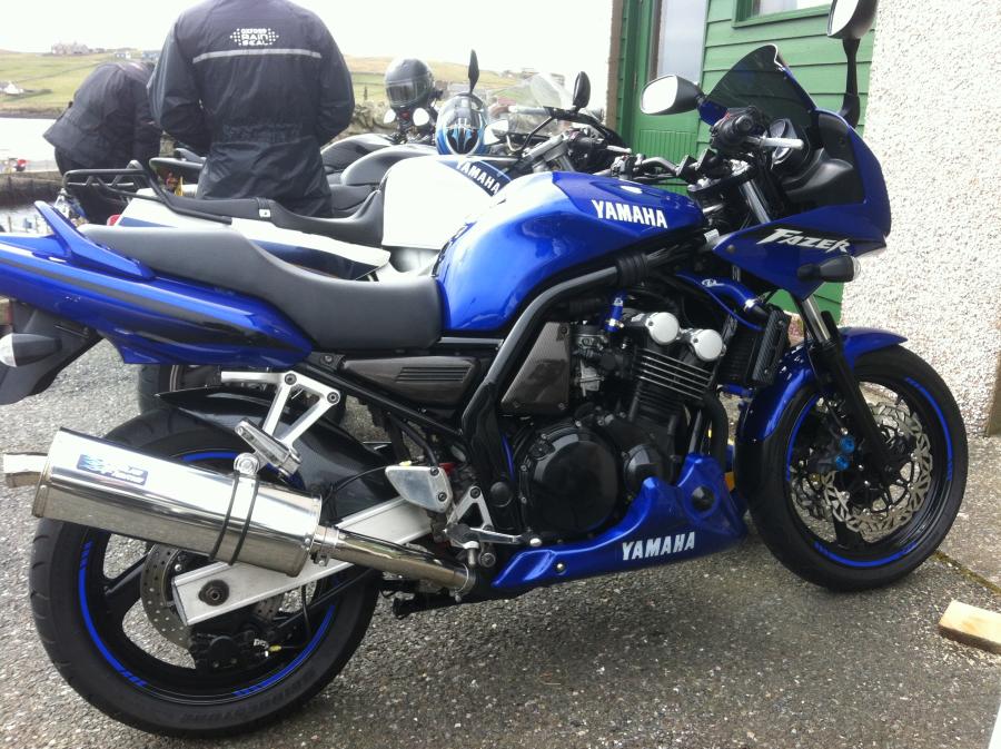

The pipe that is bigger at one end is the large pipe from the coolant filler cap to the top right of the radiator. As seen here:
Chris
[Image: 208008.png]
(07-04-15, 08:14 AM)Chris link Wrote: The pipe that is bigger at one end is the large pipe from the coolant filler cap to the top right of the radiator. As seen here:
Chris
I see :-(
Is there much difference Chris?
Nice bike btw :-)
Where did you get the rim tape from, I much prefer that idea as apposed to all the way round, but I'd need to get it in the faster colour of red lol
Colin
I seem to remember it being considerably different. I really don't think the viper pipes would work, there are a few pipes that have very tight turns on them, others that have several turns in different directions (so the viper pipes wouldn't sit right) and almost every pipe is a different size to the other pipes so would be a complete faff to get the right sizes. Your best bet for getting pipes is to get them from sfs, they already have the tooling/sizes/dimensions made up for all the pipes so they just have to run off another batch.
