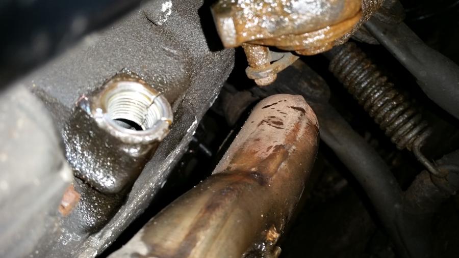

Like a muppet I got confused when undoing the oil drain plug and ended up tightening it not loosening it.
Yes I have split the casing.
is there a fix, or is a new case?
Thanks
Post up a good close up picture so we can see the extent of the split.
Flippin eck I would not of thought that was even possible to do

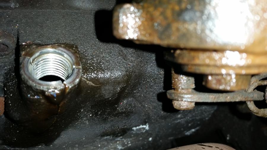

pictures of my damage
I have found a replacment engine, bottom only for £30 but don't know how much it will cost to build it from mine :'(
(23-01-15, 06:17 PM)Exupnut link Wrote: Post up a good close up picture so we can see the extent of the split. Then we can really take the piss.
:agree
bloody hell. The wrong plug must have been fitted as the thread should strip before that happens. Either that or you have got a fault crank case.
HAHAHAHAHAHAHA nice one Dazza...... Seriousley tho that's weldable..... Take it to an engineering shop and get em to weld and retap it. No more than £50 and get em to put the bike on its side for access.
Surely that drain plug is in the sump casting and not the crankcase. You can remove it without taking the engine out but the exhaust will have to be removed first. Then get it welded up and re-tapped or just replace it.

If it is the 1998 1999 FZS 600 then all you need is a replacement sump, loads of them on ebay. Any sump from 1998 to 2003 FZS600 will fit
Remove the downpipes remove the exhaust gaskets, undo the 14 sump bolts, drop the sump clean off the old gasket, replace the gasket fit the replacement sump (with the 2 dowels), replace the exhaust gaskets replace the downpipes, fill with oil and away you go  Smile
As unfazed....just replaace with a good secondhand one, cheap on ebay.......be carefull when taking the downpipes off, the studs in the head break/strip easy and are a bit harder to fix than your sump.....
