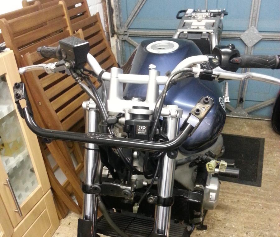

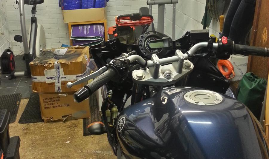

Sorry to bump this again, but I'd appreciate it if someone could confirm if this is how the top of the forks look on a stock bike before I start playing around with things...
Hopefully attached, are a couple of shots of mine at the moment. Not taken specifically to show the forks, but you can see fork tops and fronts in these shots. The bike is standard, as I had it from nearly new (ex-demo).
Hope this helps.
With the fork cap bolt off, the top of the fork leg tube (stanchion) should be flush the the top of the Yolk.
Hmm, ok that looks like mine are as original, not been lowered.
Thanks.
