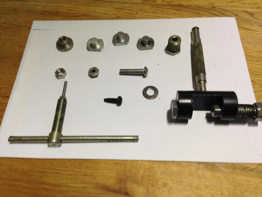

2. Please can someone provide pic by pic with notes for removing the chain link and revetting a new one in. I have bought a tool from preloved but came with no instructions so not sure how to use it, came with no instructions. Pics of tool and parts included. 2nd pic has the parts inverted  to show both sides of them. the round thing with a flat edge (top left) - I've got two of these, just forgot to include it in the image

thanks but its not the instructions for my tool and I do not "get it" for my tool with its specific bits n pieces that come with it. Thanks for trying though and appreciate the time taken to upload

Ok guys, I'm listening... You have convinced me
May we turn to questions 1 and 2 please. What are our opinions on this.... Any practical examples pic by pic would be a real help. Appreciate your continued support and advice
