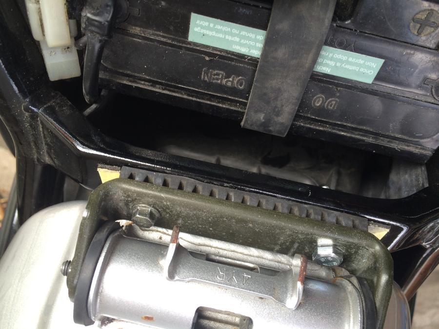

Interestingly I looked at the tank mounting bolt by the seat and noticed the whole mounting is quite loose. You can't tighten it up though as there's tubular spacers over each bolt. I think the rubber padding must compact over time and mean the bolts (and tank) can move slightly. I removed the tubular washer/spacers and tightened both bolts up and it was much better in terms of vibration. I'll see if I can get a new rubber buffer thing or make one that packs it out to the correct width so the bolts can be tightened.

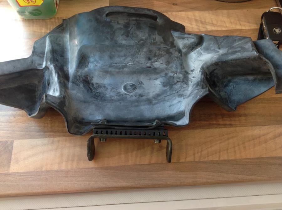

It's 2001. the allen key pivot bolt is fine, it's the 2 mounting bolts that attach the bracket to the frame and the slatted rubber mount that won't tighten. Ive packed it out now and it fits tightly.

It's these 2 bolts in the photo, attaching the bracket to the frame. The ridged rubber pad doesn't totally full the gap so the braket can move around on these 2 bolts.
Sorry pic is upside down for some reason!
Here be the offending article which ive got out the shed and ive flipped it upside down on purpose.
How does it compare to yours?
Mine all seems in order and wasn't causing any vibrations.
Out of interest have you tried anyone else's fazer coz maybe its just a quirk of the bike or like others say it could be engine mounts etc etc.
To be honest it's bettter now I packed the rubber out. I still get some vibration through the tank but I think that May just be normal.

Check if the rubber cover that fits over the air box is under the tank hinge.
