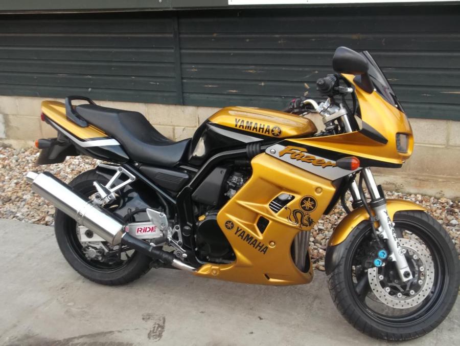

Wrote off my gpz500 last monday on a ford KA that didn't see me  :eek  and now my leg has recovered I have just brought my new steed home. Loving the colour and it goes well, although it does seem to hesitate and run a little rough sub 3000rpm. Hopefully some tlc and a slight service will help that once I get some OK weather.

Welcome to the site, that's a very nice looking bike.  Smile
I have never liked full farings on the FZS 600 or 1000....but that actually looks ok
Nice one  :thumbup . Do the carbs, that should sort yer issue. Was the wee girl thrown in with the deal, or was she yours already?

Glad to hear everyone's consensus on the carbs, I have the carbtune in the cupboard so when I get some nice weather I'll set to balancing them, and check the plugs at the same time.
I'm not sure myself whether the lower fairing will be staying, I'm not too keen on them either, plus it kinda gets in the way of maintenance
I was a little nervy riding her home today after the accident, but I needn't have been as apart from the stutter it was quite an easy, civil ride. Also that front fairing seems to protect the hands some, and they didn't get cold; even without heated grips.

Hey, welcome along.
Glad you're ok after your accident, bike looks good  Smile

Just a thought... Is it running on all four below 3k? I worked on a Kawasaki ZX9R for a mate that was lumpy as chuff below 3k. Carbs off, cleaned... Ran fine for a minute then went back onto 3. Thought it was fuel starvation but it was over fuelling on one cylinder and fowling the plug. Replaced needle, seat and seal and all fine. Worth a try if balancing doesn't work  Smile
Looking good, I quite like them in gold. The tuning fork stickers are the wrong ones though!!!  Wink
I was sitting on that bike a few days ago at P&P' s, I guess you are the lucky new owner ? lots of bikes from sales places have sat around for a while as they are moved from dealer to dealer, so I would just put in some fresh petrol and do a hundred miles or so before thinking about touching anything. Also, if you have any real problems take it back, Peter the owner relies on his reputation and won't hesitate to have it back to sort any problems. Simon the mechanic who works there is very experienced and totally trustworthy.
