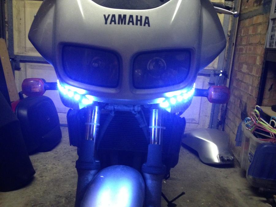

Fitted my hot grips today, piggy back fuse on the turn signal, 5a fuse in the piggy back plus the inline 5a on the live wire.
Whilst I was at it, I fitted 2 led strips and wired them into the hotgrips power cabling, £2.95 on eBay.  Somewhat overpowered by the headlights but I have some side coverage with the DRL's so more chance of being seen.
All seems to work ok Smile
[Image: 300668.png]
They're actually white but look a little blue on these pics

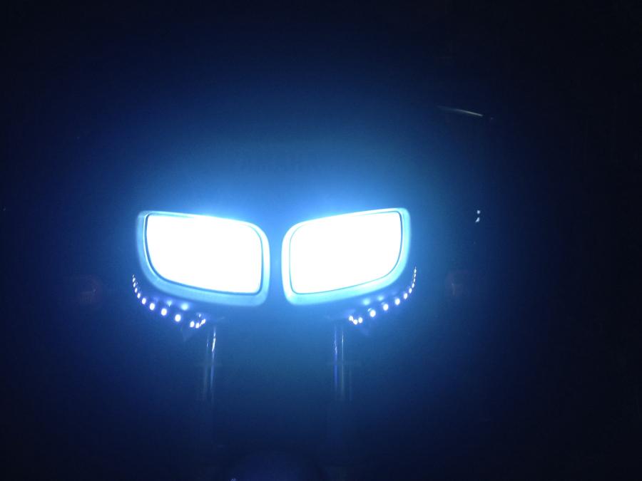

What lights have you fitted mate? HID's?
Yeah headlights are HID

Sorry for the Hijack which HIDs?
Any issues with MOT or melting the internal housing? DRLs look good btw Smile

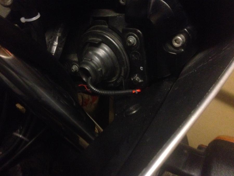

It's a funny story about the HID's, and my garage looks like a hid warehouse!
Set1 - Ordered 1 set from China, h1 and h4-3, £23
Got impatient waiting for them to arrive
Set2 - ordered a pair on eBay from a Chinese seller but despatch from the uk, asked them to send a h1 and h4 bulb. 2 days later, I received 2 boxes from them, 2 pairs of h1 so 4x ballasts, 4x bulbs. £18.
Improvised the h1 to fit the h4 socket.
Set3 - Bought another set on eBay h4-2 as I wanted a h4 bulb. £18.
Set 1 arrived 2 days after set2, so I put the h4-3 in instead of the improvised h1.  Set3 arrived another 2 days later!
All 35w and 6k.
So for under £50, I've got 8 ballasts, 5x h1 bulbs and 3x h4 bulbs!  Should keep me going for a few years...
Only fitted for a week now, no problems with the glass.  As for mot, it'd only take 5 minutes to change to normal bulbs if necessary.
H1 - single hid bulb
H4-2 - hid low beam and halogen high beam
H4-3 - single hid bulb which moves for lo/hi beam.
I have h1 (left side) and h4-3 (right side) fitted in the picture.
Planning on buying a h4-4 bulb to try, 2 hid bulbs, requires 2 ballasts. Think I may have a spare laying around!
