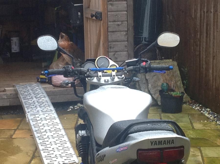

They're not as acutely angled so easier on the wrists, plus about an inch and a half longer on each end which makes for more of a natural position and more leverage,not much difference in height.
Heres a quick pic while my bike is getting a little rain wash down.
what mirrors are they nogg?...and are you using same mounts?
(06-11-13, 01:11 PM)CRH link Wrote: what mirrors are they nogg?...and are you using same mounts?
Off a yamaha xt660 buddy, using the original switch gear screw in mounting points.
Really good mirrors to be fair, a bit like mickey mouse ears from the front but they do the job nicely & being a genuine part the quality is good.
k mate cheers!!...ile have a look for a pair!! doing away with them on foxeye fairing!!...fancy some on bars!!
