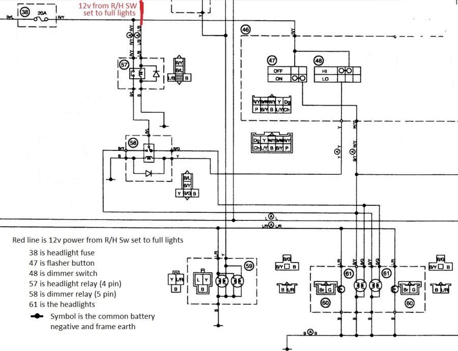

I have attached a diagram of the headlight circuit.
Since the the 4 pin relay is clicking then there is power to it, ruling out the right hand switch.
Check the headlight fuse had power to it and going through it.
You need to determine if the switching contacts in the 4 pin relay is working. The clicking only means the magnet is pulling the contacts closed but the contacts could be burned out.
If the previous owner had used larger wattage bulbs he could have burned the contacts of this relay also.
Check to see if you have power to the black/blue wire of the 5 pin connector with the ignition on the R/H light switch set to full on.
If not then check if you have power at the red/yellow of the 4 pin connector relay (this is direct from the fuse) and then (keep the ignition and R/H sw on) with the relay plugged test for power at the Black/Blue at the back of the connector this is testing the contacts of the 4 pin relay. No power there with the ignition on the the R/H switch on means a new 4 pin relay also.

The Dimmer switch on the left handle bar switches on the 5 pin headlight relay which changes the contacts to send power to the main beams which comes through the contacts of the 4 pin relay (follow the line from the 20A fuse to the first relay (57)) and since the dims work it proves the 4 pin relay is working.
Can you hear the 5 pin relay clicking when you operate the switch to main beams. If not you need to supply 12 volts to the yellow wire of the the 5 pin relay and see if it the relay clicks and main beams come on. This would prove the relay works and would point towards the switch being a problem.
If only one headlight comes on with the flasher it may be a blown headlight bulb. If you look at the diagram the 20 amp headlight fuse supplies power via the flasher switch directly to the bulbs in 61 in the diagram. Swap the bulbs to see if the fault changes with it.
